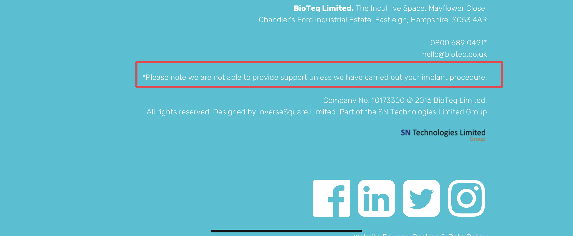

Also of concern, they sell an implanted device and service, then at a cheaper price a ‘use your own installer’ pack - but have this on the footer of their website.
Pay our inflated prices or we will refuse to support our own products… yeah, thats a big no from me. I understand they can’t warranty the install, but to say you offer no support is a big NO DEAL for anything going in my hand.
