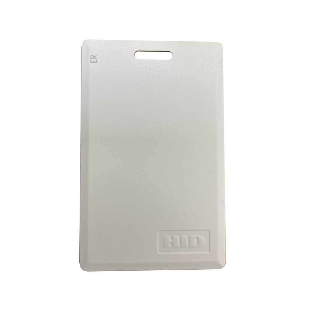

I am trying to clone my apartment card, pictured

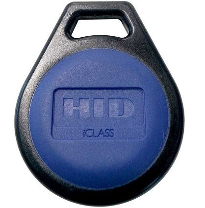

to a key fob, pictured

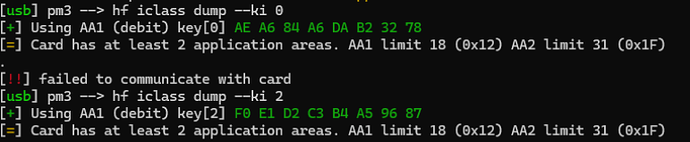

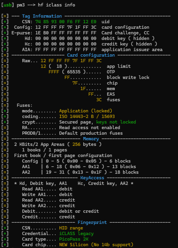

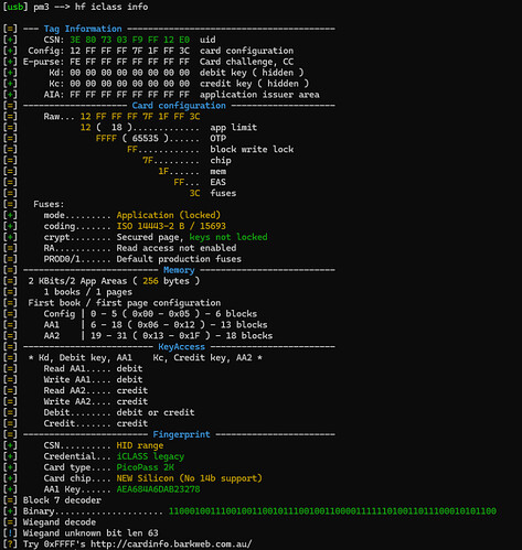

I can run hf iclass info on my card and get this result:
I can also run hf iclass info on my blank key fob and get this result:

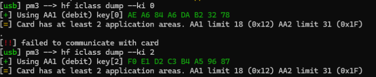

However, when I go to run hf iclass dump --ki (0, 1, 2… etc) on my apartment card I get this response:
I can run hf iclass dump --ki 0 on my blank fob with no issues.
Appreciate any help guys, sorry if my issue is something stupid!

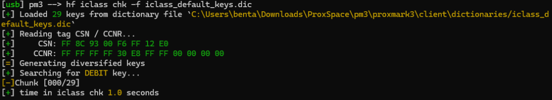

Try a hf iclass chk -f iclass_default_keys.dic to make sure you’re using the correct key

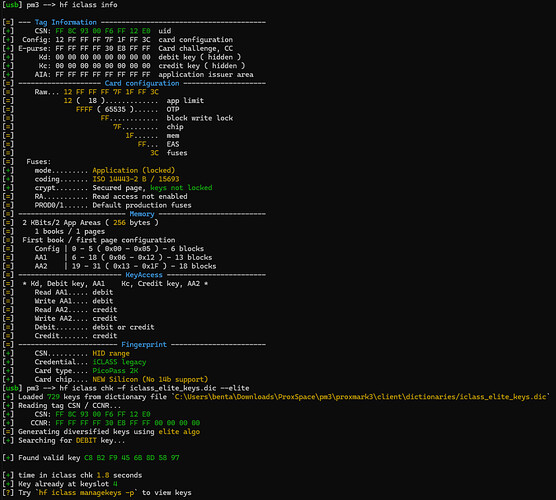

This is the result
It looks like it didn’t find a valid key for that card

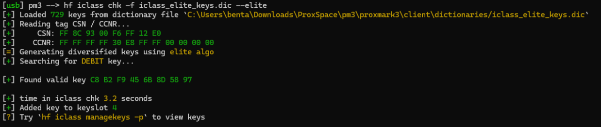

Give hf iclass chk -f iclass_elite_keys.dic --elite a try too
Looks like it found a key
hf iclass dump --key C8B2F9456B8D5897
And you’ll use that key for all future commands on that card.
You can use the hf iclass managekeys command like it suggests to save that to a key index, but I’m too lazy for that personally

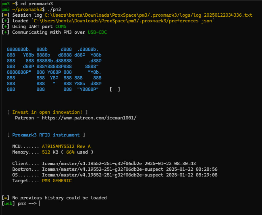

Can you post the output from when you first start the PM3 client?

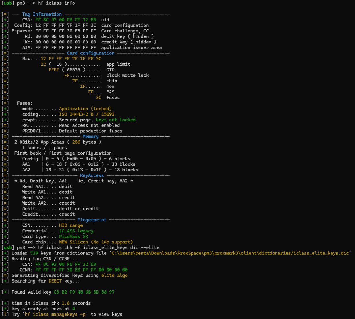

The CSN in the screenshots from your hf iclass chk commands doesn’t match either of the CSNs of the two scans in your initial post
That seems strange to me…
You might retry those commands while moving the card around again, see if you can get the CSN to register correctly.
I’d also try a chk on the blank fob and see if that returns the correct CSN, if it doesn’t it could be an issue in your client version
Ran the commands again and the CSN matches on my card
Matches on the blank fob aswell
Unsure what happened
Give hf iclass dump --key C8B2F9456B8D5897 --elite a try
