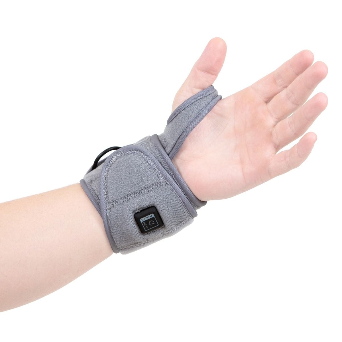

and another high power idea, a heater element above the veins in the wrist for cold days, sort of like these:
Is this feasible? we could do some even more interesting party tricks with more power, maybe even interactive implants with buttons of some sort (snake or tik-tak-to in my arm?)
In short, with enough focus and money I’m sure those things could be made and made safely but the amount of money and time necessary is impractical.
I want to preface this by saying that this is in good jest, not mocking here (new ideas are how progress is made :grinning_face_with_smiling_eyes:) , I would love to see an LED array implant, but regarding the heater one…
The idea of having a heating element under my skin, near my veins…

Even though it would be powered wirelessly by a power source I could remove or deactivate, it still scares the hell out of me.
It just doesn’t make much sense, if you have to attach a power source to wireless charge it…then why not just have the whole heating apparatus in the external device. An implant in this use case solves nothing.
Since the idea would be to heat the blood directly as it passes through the veins, in-theory it would be very slightly more efficient to not have to heat the dermis above it. However, any tiny efficiency gain here would almost certainly be immediately stripped away by the losses from powering it inductively.
To be clear, I don’t disagree haha
Yeah ok, maybe not the heater :yum:
