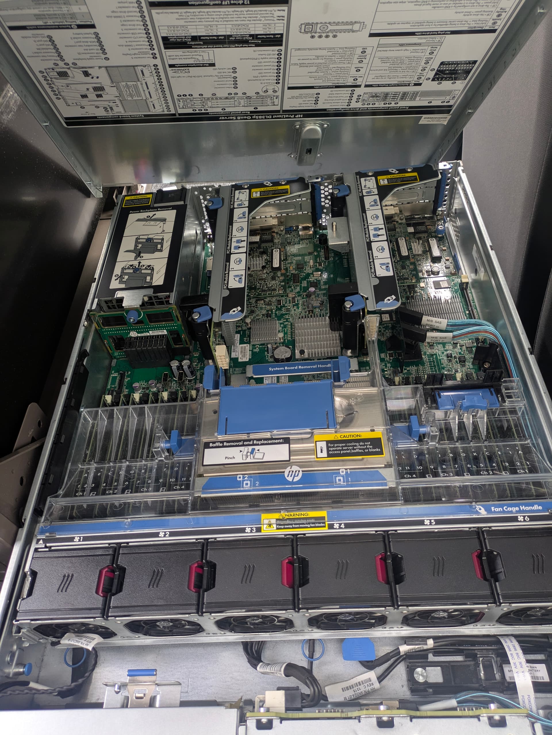

So after owning my rack for almost a year now. I wish I would have went with a less rack solution. Desktop servers seem to be both quieter and have larger options for expandability. But I’m not unhappy with my choice.
I’m sure I’m gonna be at the same place, but for what I payed for mine I couldn’t even buy the ram thats inside … it’s gonna be a good learner and donor when I figure out what I need/want and how to put it together
Noise is a worry, but I have a few ideas (and it’s part of the reason I went with a 2u )

Oh no. What if you spilled a coke on it? bad thoughts, bad thoughts.

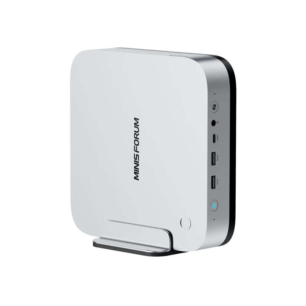

That company that makes the Satellite that I put a picture of is coming out with a nVidia Jetson based AI computer.
What’s interesting is that this unit uses unified memory so you aren’t limited by the RAM on your video card. You tell it what you want to use for GPU and what you want to use for GPU. Of course you are still at the mercy of the processor so having enough ram to be able to load a 30b model isn’t really useful if you don’t have the processing power to do something with it.
It does have occulink as well so technically you could run an external GPU.
