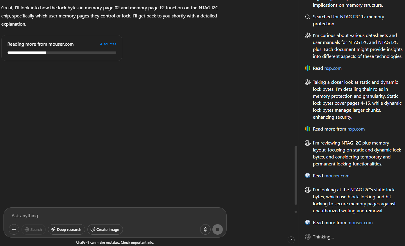

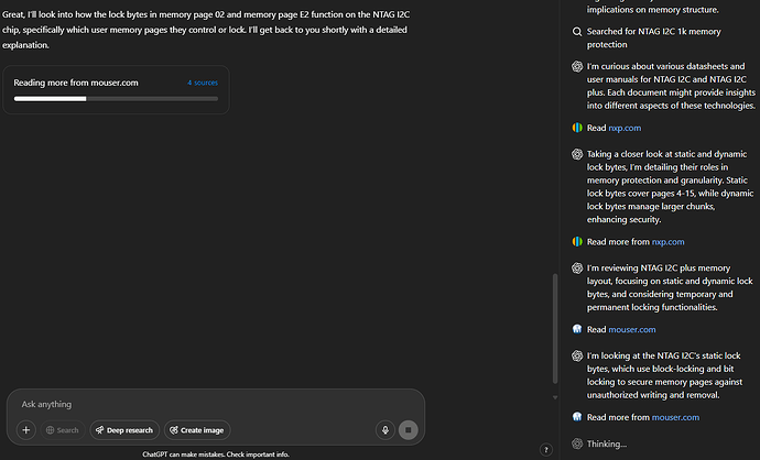

This is kind of what I mean… the way “research” works on OpenAI … it sucks in information on demand… interprets it… moves forward through it…
No RAG… no vectorizing… no vector matching… raw NPL on raw data… and yes it is slow AF… but it is much much more accurate. I want this for my local document / data stores… start up some threads… get them working… queue jobs if you need to… spit out what I am looking for.

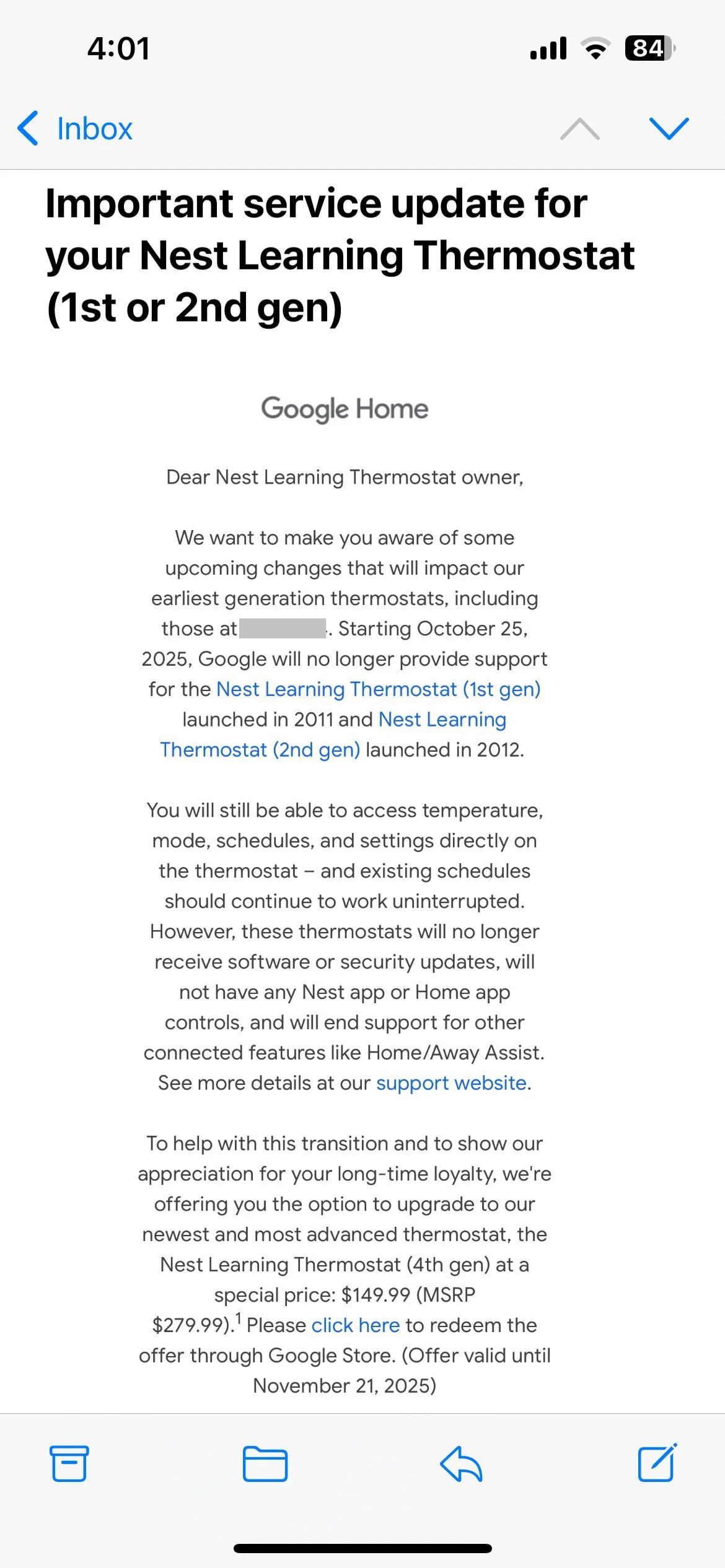

Just another reason to go local. Looks like I’ll be replacing my thermostat with something controllable through matter or zigbee.
