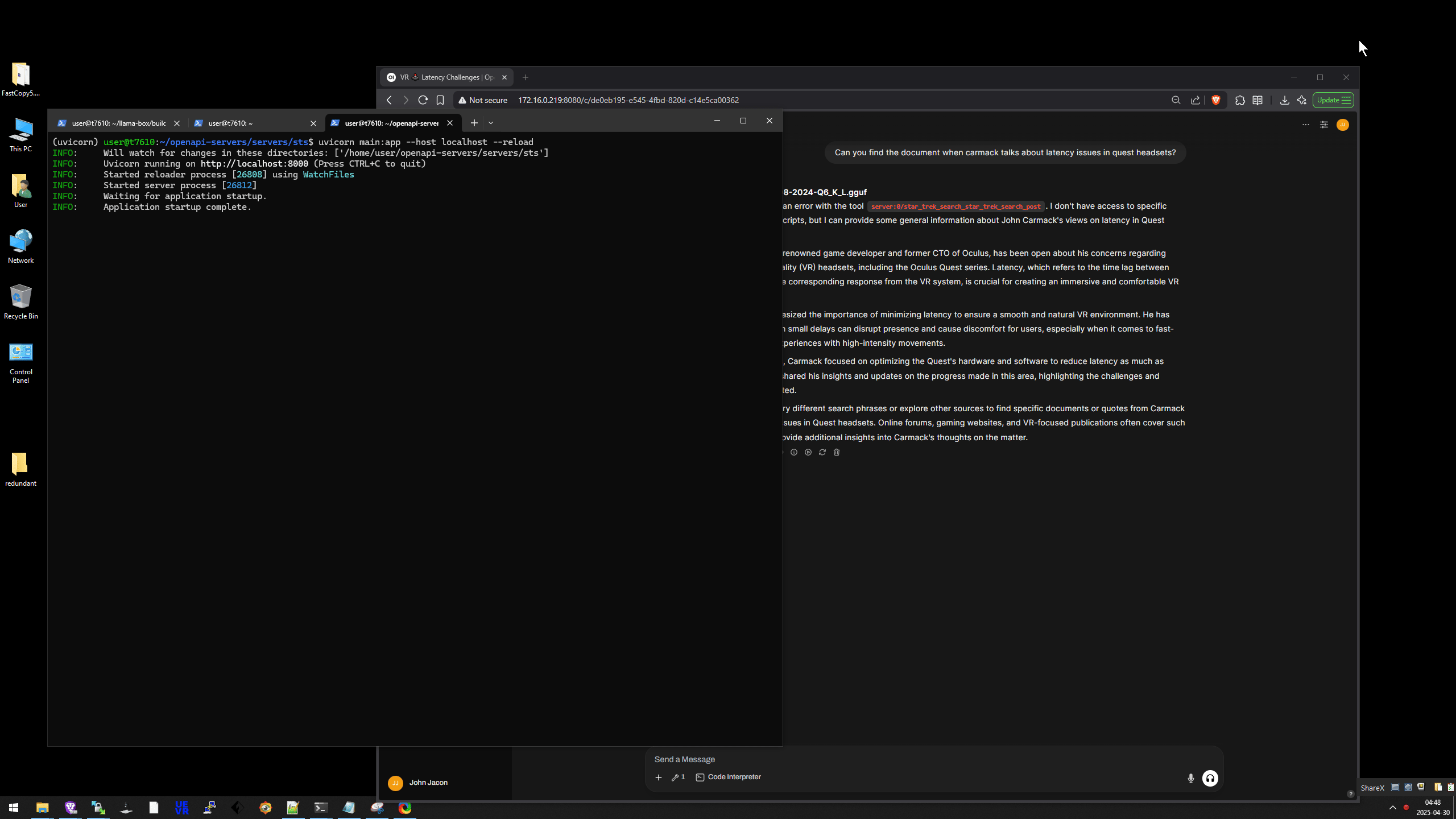

I made a little proof of concept script. It uses koboldcpp because I already had some tooling made for it, but it doesn’t install or modify anything in your system – it is a single executable you can just delete it when you don’t want it anymore.
ooo shit that’s awesome… I’ll take a stab at it soon. The whole fam is sick except me so I’m playing both doctor and sexy nurse until it passes.
What do you think?
Note: This is in real time, and I am using a 35 billion parameter model, so it’s kinda slow.
(open gif in a new tab)
explorer_gk8BBNiLzi
Repo:
Instructions:
Download files.
Install requirements.
Install uvicorn.
Edit config.py to point to your documents directory.
Run:
uvicorn main:app --host localhost --reload
Go into OpenWebUI admin panel, settings, tools. Add server http://localhost:8000
Click on + in new chat, select the tool.
Ask the model a question which has an answer in one of the documents in your documents directory.
Wait a really long time.
