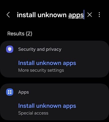

Still debating whether I can trust this, my phone seems to have second thoughts, the download is not taking place. Probably I have to tick trust third party content somewhere.
