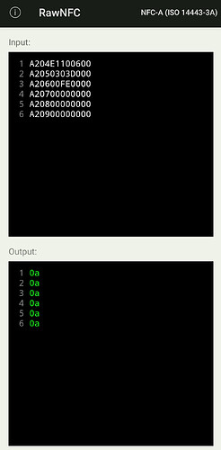

Another example is writing a blank NDEF record to an NTAG chip;
dnfc://NfcA/A204E1100600/A2050303D000/A20600FE0000/A20700000000/A20800000000/A20900000000
NTAG_BLANK_NDEF
If you have RawNFC installed and tap the link above, RawNFC will open and 60 will be pre-loaded into the input window;
Now tap any NTAG family chip to execute the command and get back the VERSION information from the chip;
The line numbers of the input textbox correspond to the line numbers in the output textbox. To share the output, long tap the output textbox to get an option to copy the command and response history to the clipboard;

Setting a blank NDEF on your Type 2 NFC tag
Sometimes NDEF records get borked which can cause problems writing or updating your NTAG / Ultralight. This is the first step in attempting a recovery.
Write blank NDEF
This command will simply write a blank NDEF record starting at page 04 and null blank the following pages 07, 08, and 09 just for good measure. Each successful write should return 0A in acknowledgement.

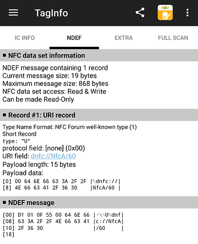

The custom Uri trick is going to be great for sharing, you could even store a series of commamds in an ndef this way. I can’t wait for someone to create some sort of trick where they load and write commamds off and on to a chip in a loop :joy:
No trick, it just works…

Hi, I tried the Factory set on my NExT V2 because I have had problems loading from my iPhone 12 mini for a long time and I keep getting this error on other phones and without a phone.
Hmm this seems like coupling to me. Can you get a read with taginfo?
