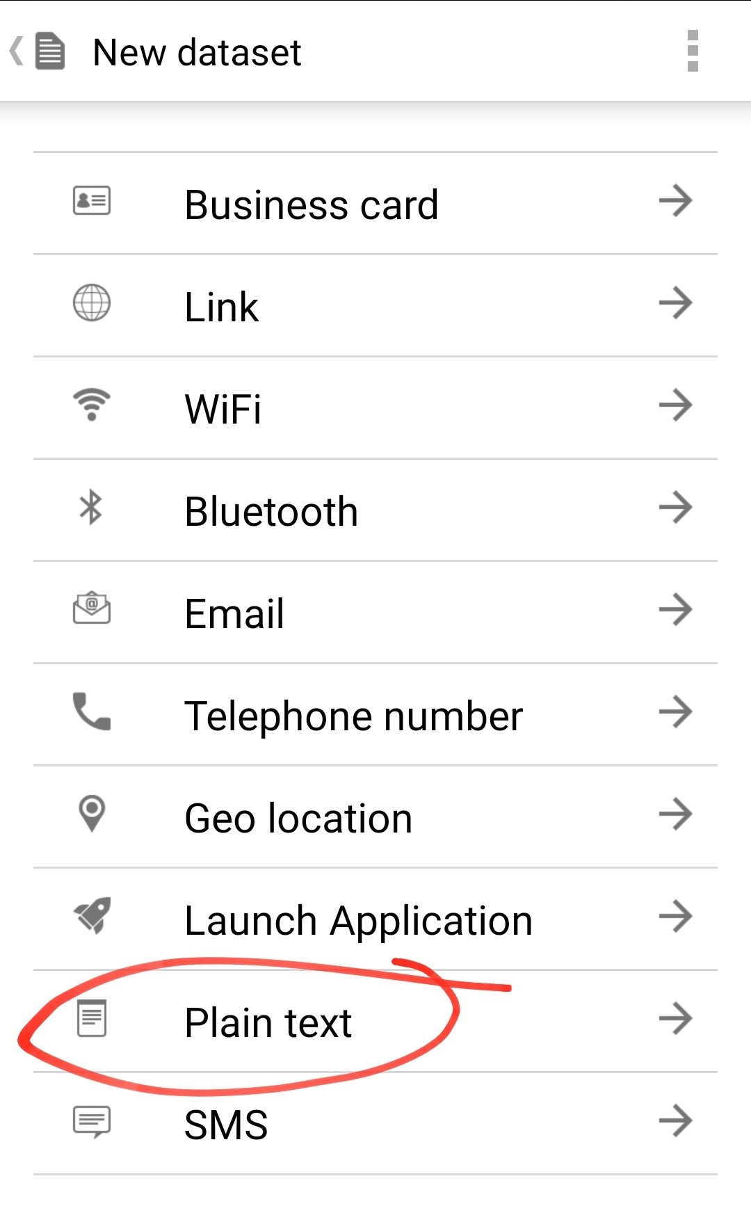

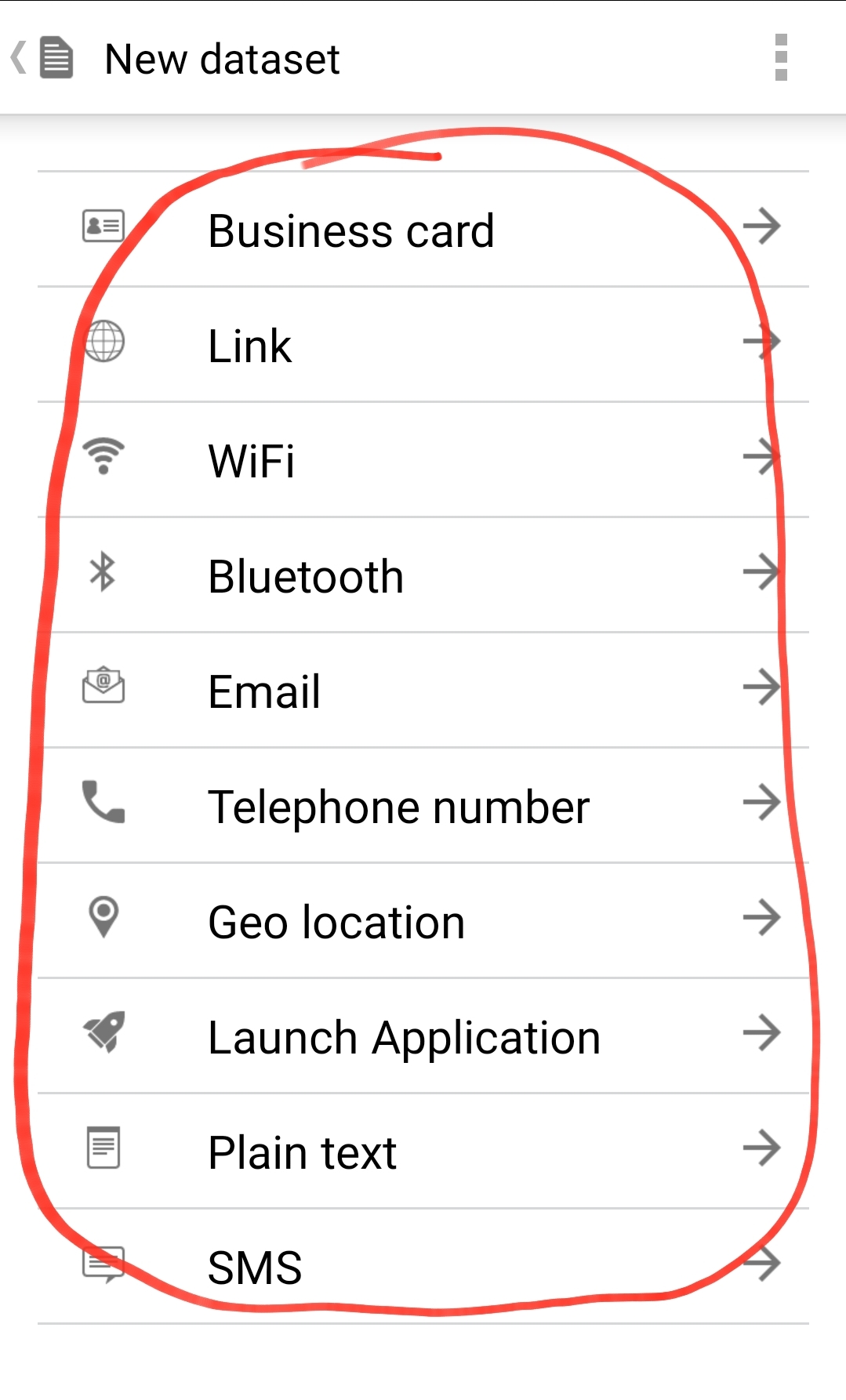

Awesome, so now using TagWriter,
Let’s do this in parts.
First Use TagWriter and set up a record
Then Try to write that record and tell us what happens…
Okey it saved sussesfully :slight_smile: what now ?
Awesome, that sounds like your problem is fixed :+1:
so NOW you can write whatever you want onto your xSIID, just just choose a new data set, choose whatever you want to write to your xSSID and you are done.
