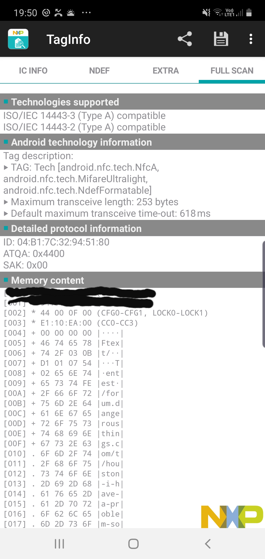

Can you please can using taginfo app, five us a screenshot of the full scan page. If it makes you feel better you can hide block 00 and 01 as thats your UID
Lik this ?
YES!
Ah ha!
Right scan your tag if nfctools (dosnt need to be the pro version), and post that to again block the uid. I just want to be sure before I tell you what to do.
Okay this is wacht i get
Right I know exactly how to fix it, as I accidently did this last night!

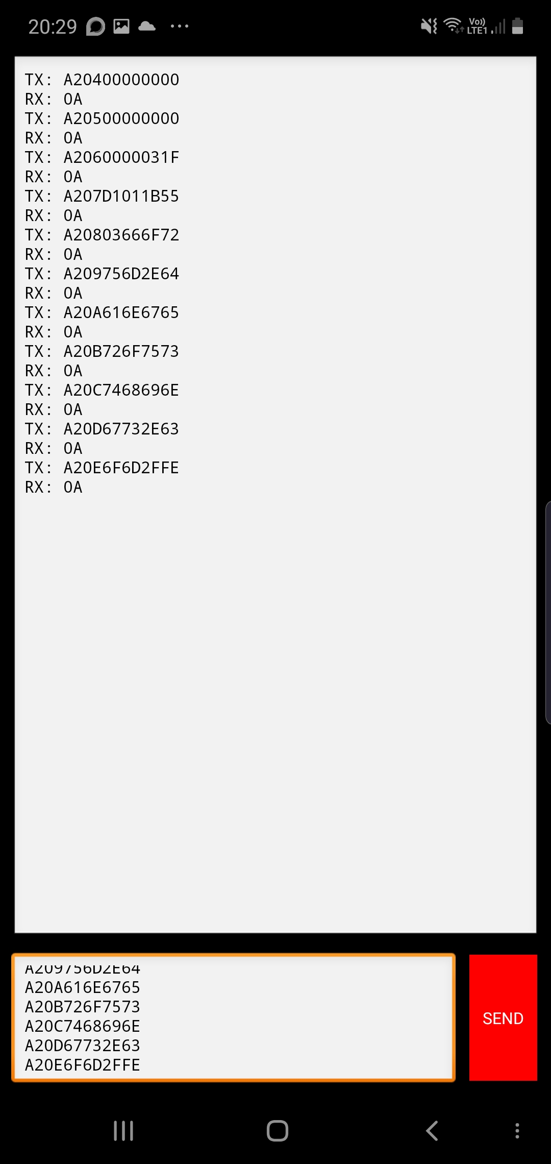

Paste this into it exactly as shown then take a screenshot:
A20400000000
A20500000000
A2060000031F
A207D1011B55
A20803666F72
A209756D2E64
A20A616E6765
A20B726F7573
A20C7468696E
A20D67732E63
A20E6F6D2FFE
Do i scane the chip first ?
No, copy and paste it in press send then scan and hold the phone still
Okey and now i get this tis this good ?
Yes! Now scan it outside of the app
