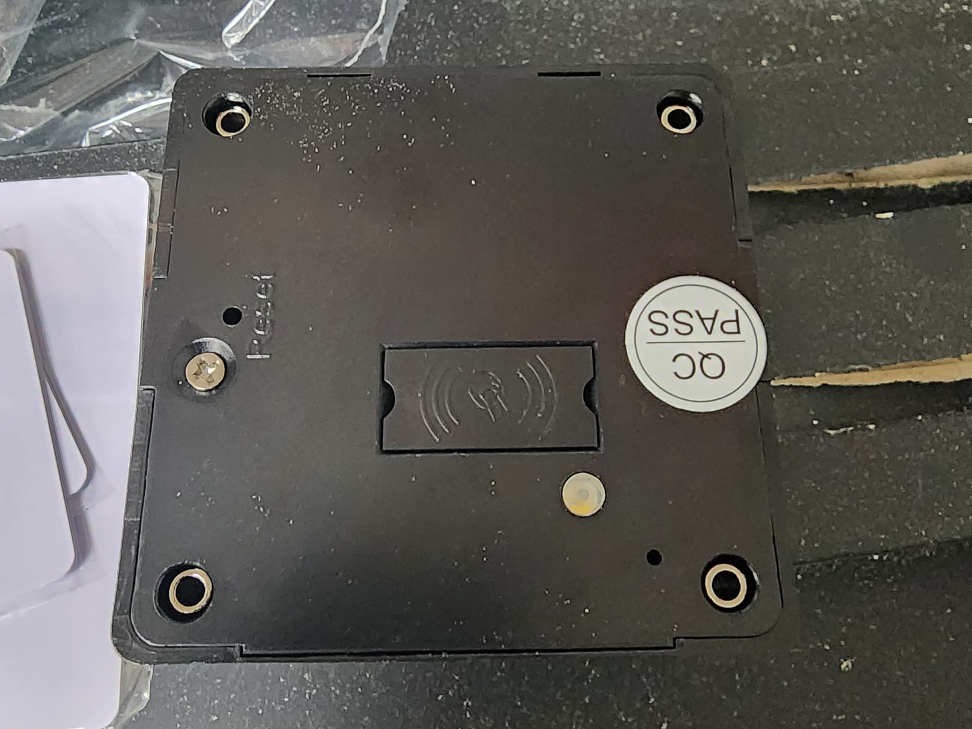

can you post pictures of the readers you use the card with, if it’s one we recognise there’s likely some word on how well implants play with them.

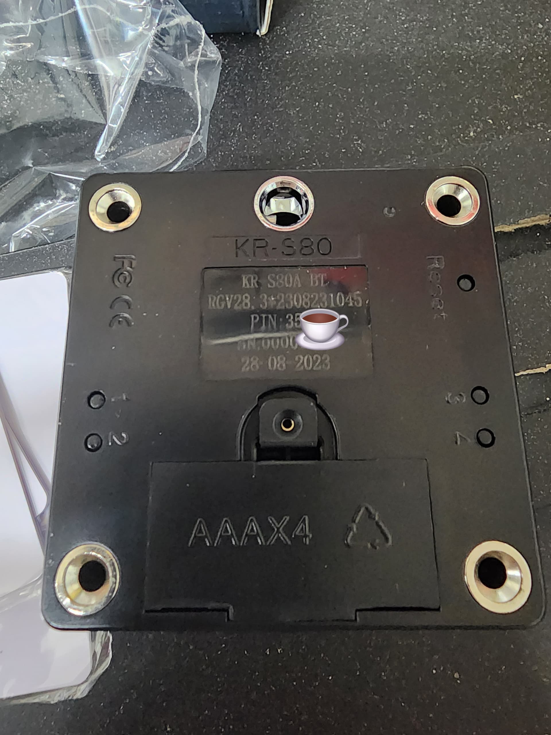

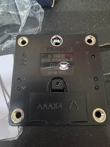

Here’s the reader, some disassembly was required… I covered the serial and pin for now in case those are supposed to stay secrets…

That doesn’t strike me as the kind of reader that is too picky about what kind of chip you present to it
So you might be able to get away with a cheaper chip if you wanted, that’s all
I have something similar, maybe not the same, but similar. I can tell you that it reeeally doesn’t like to pick up my xMagic. Maybe got it to work once or twice ever. I would probably lean towards a flex on that one. (Granted mine is behind a very very thin sheet of wood)
