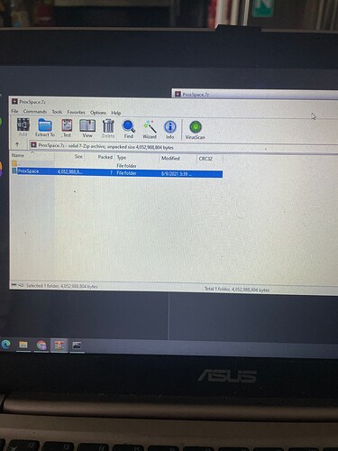

I’m having a little bit of problems I’m not sure Im understanding how this works I don’t know if it’s because the file can’t be found or ifi. Put it in right place ![]()
send help I love learning but with this one I may need lil more help then the average Joe
Can you catch us up on how far you’ve made it so far? ![]()
I have proxspace & winrar I don’t know what to do with them
Well what I mean is do I make a file to put them in don’t move them lol when I try to open proxspace it can’t seam to find it
Did you watch the video on the getting started page?
It will walk you through exactly what to do… but first off install WinRAR… then you can open the proxspace.7z file
Have you extracted the zip file yet?

thank you everyone I got it to work on a different pc lol my notebook was just not haveing I t all good I will get a newer one an should be fine things pretty cool I understand a lot more of it now an how to use it lol
