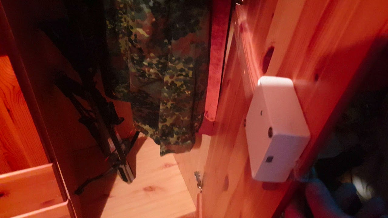

Yeah, I’m thinking about doing that. I saw photos of it taken apart and it doesn’t look too difficult to take the antenna board off and put it between the cabinet board. I was just wondering if it would be necessary. Or make a custom antenna

This lock works with the Next. But in a very very short range. Something in between the implant and lock then you don‘t get a read. That’s my experience.
Hi all, not sure if this is duplicating work others have already done but I have tested with my Rothult and XSIID and found very low read distance - essentially need to remove plastic cover and place chip directly on antenna to read at all. Unless you’re planning using it in a way that allows for having the antenna fully exposed (e.g. mounted bare on underside of table with extended coax cable as per @iahimsogard’s post above) I don’t really see how it has a practical use.
