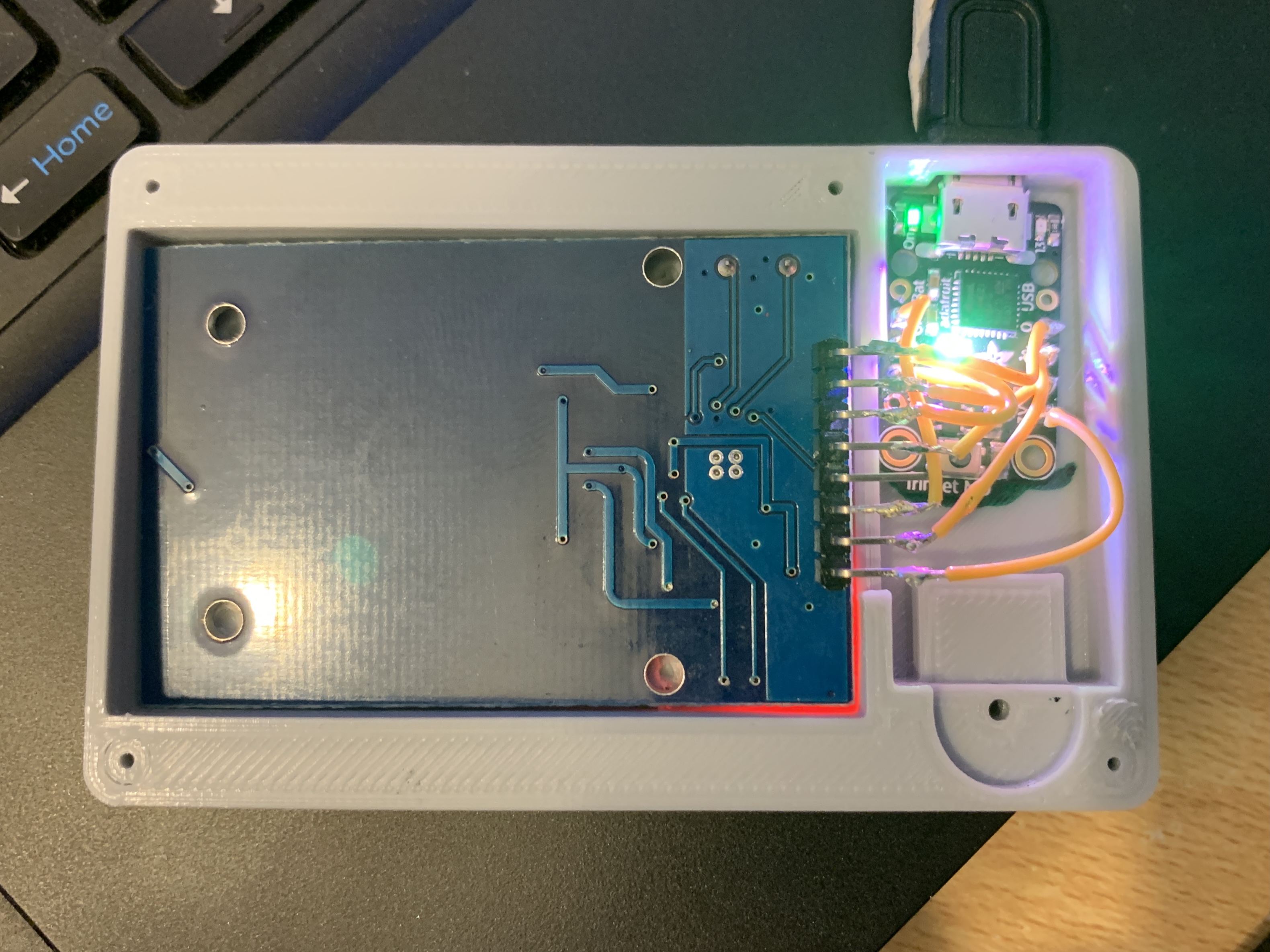

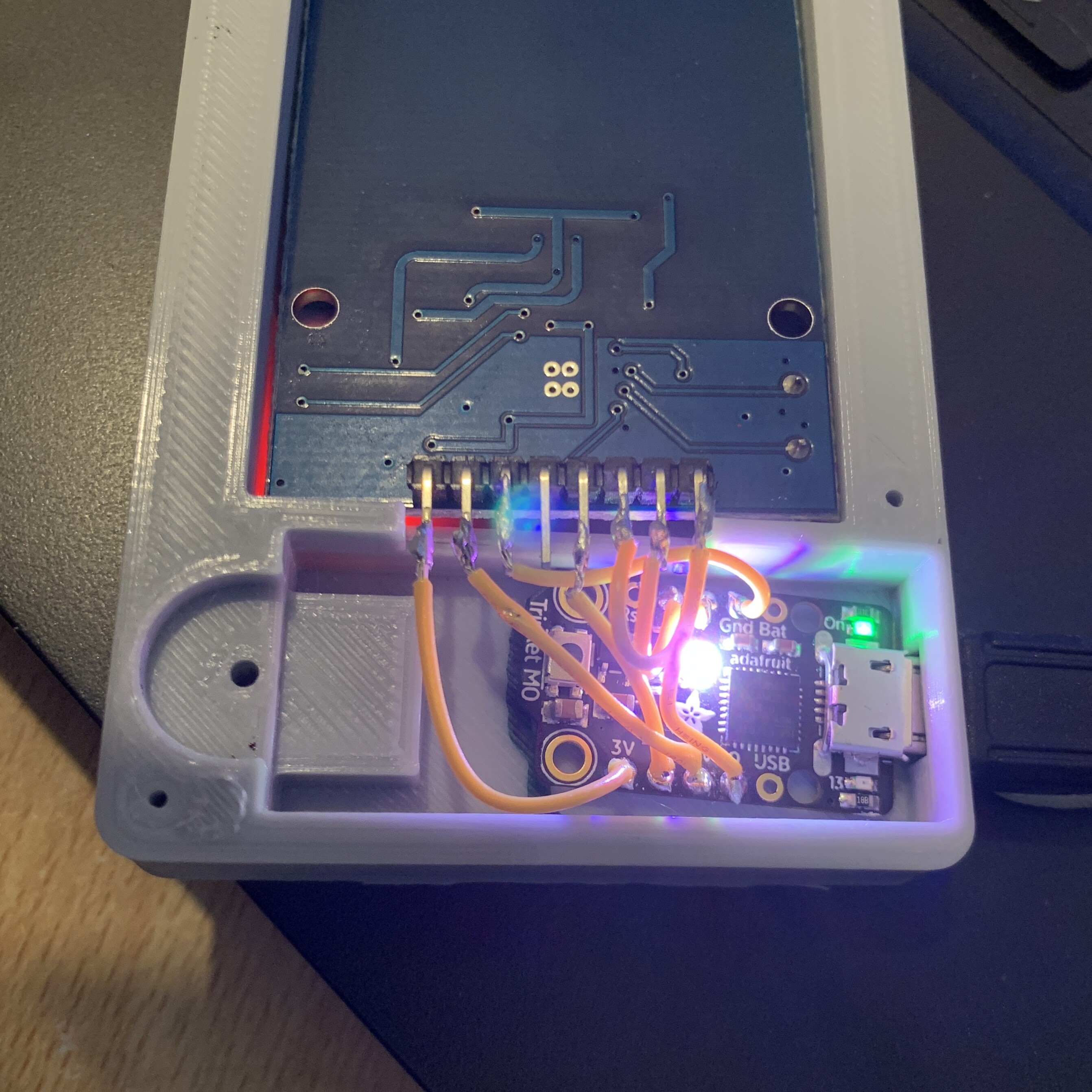

Well that was fiddly to solder:
I think I will adapt the case to fit a M0 (originally it was designed to fit a Arduino Nano) and perhaps change the interfacing method (would have preferred it without the pins but they were already on there), but it has served its purpose to me as a working prototype - it scans my implant easily through the PLA casing (see vid at top for that).
