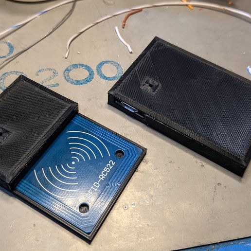

I’m enjoying watching this project progress and I’m hoping to develop my version of the setup along and then share when I can. I’ve 3D printed this case, which is meant for a Arduino Nano but will afford plenty of space for the M0. If I get time to get it in there and re-wired I’ll share pics and the experience with that case.
Never soon™ enough but here it is.
The enclosure for the RC522:
