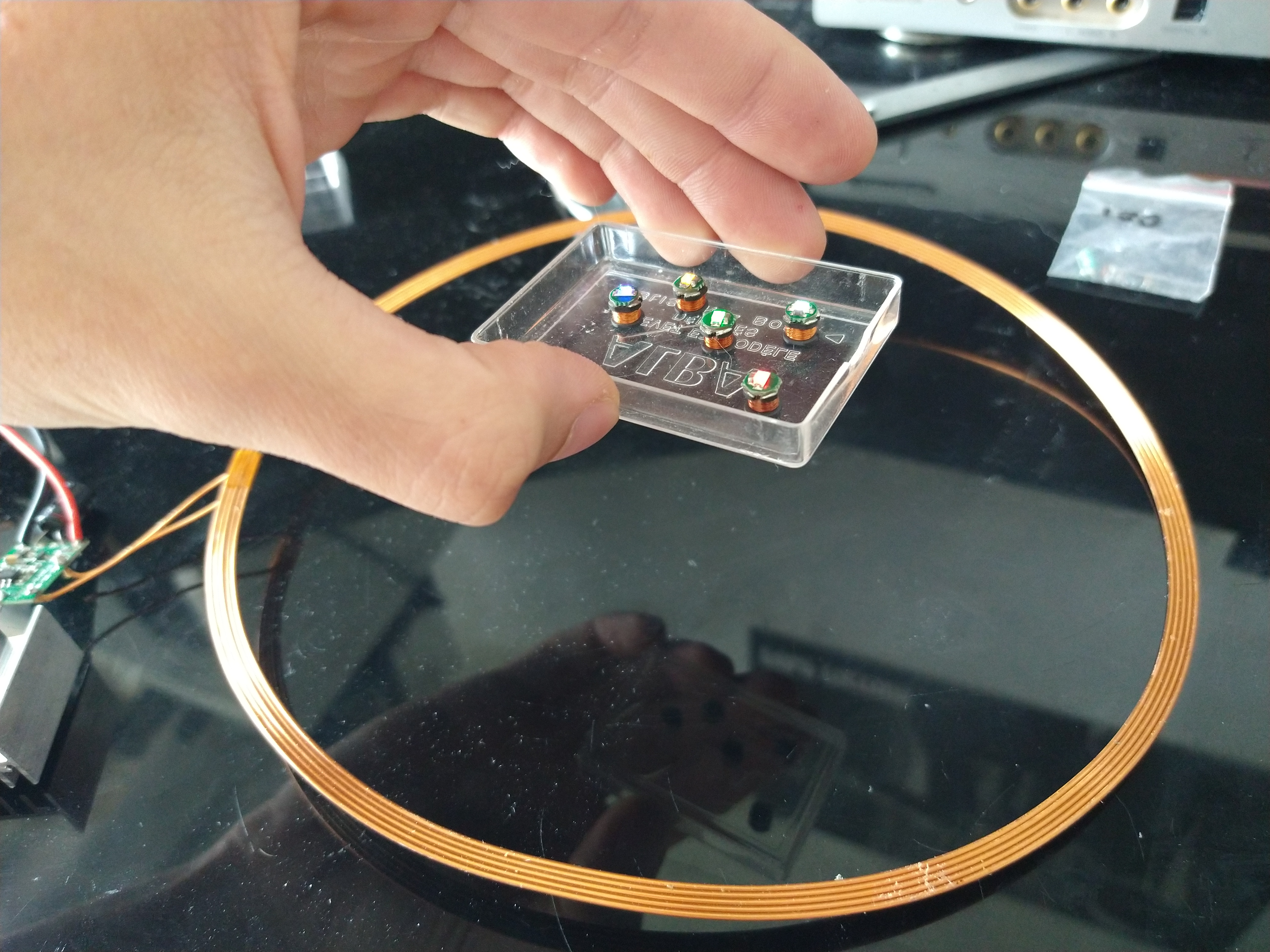

I’ve seen this for lighting up toy models etc. but never at this price… @RyuuzakiJulio sent me this post on Instagram;
Comes in small and large coil varieties…

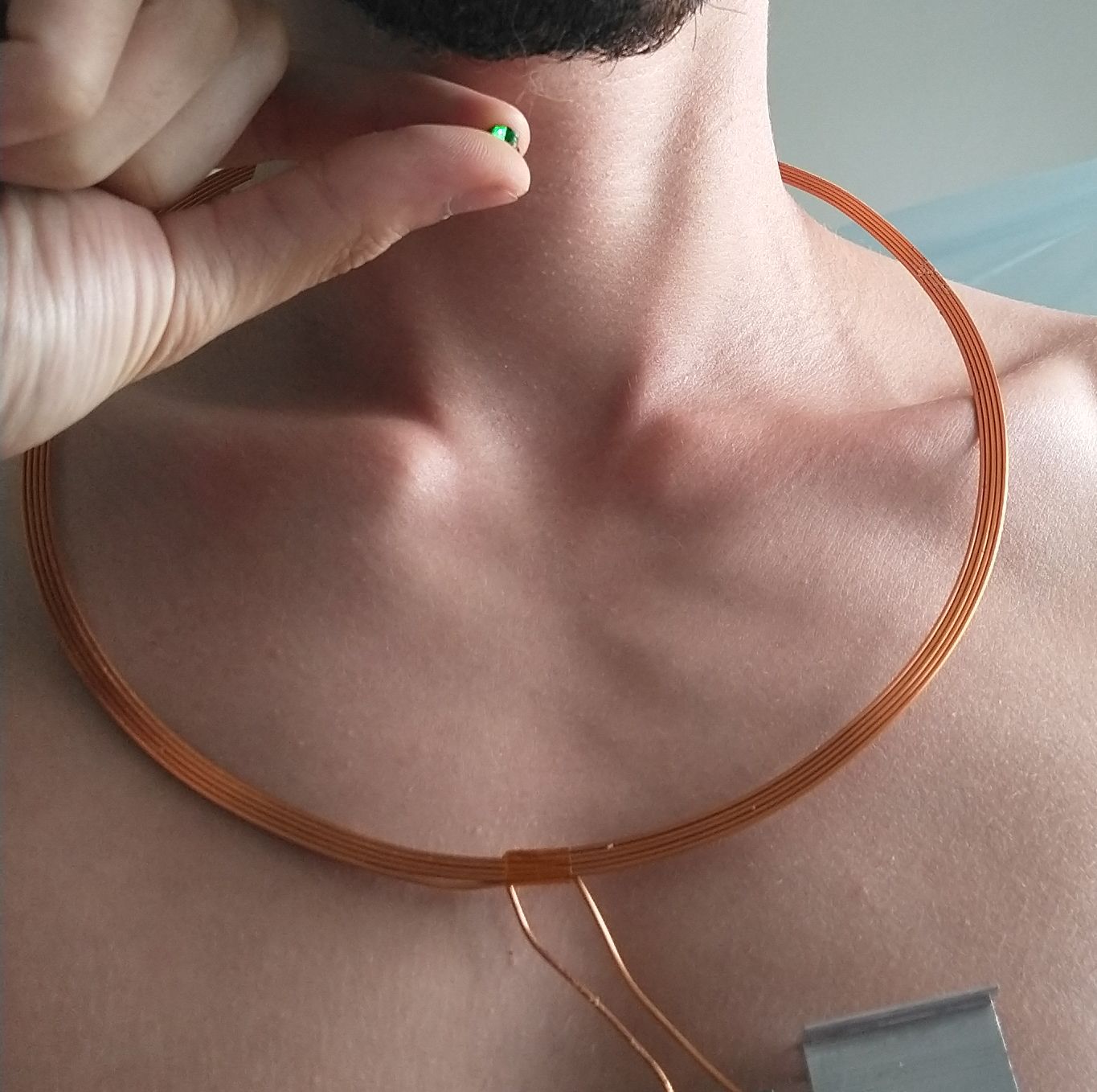

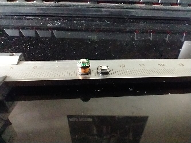

Yes I have played around with some of these while making mine… They are cool and well made but they are HUGE (in implant standards :sweat_smile:) and most of them are tuned around 180kHz.
Here is one next to what I make:
The range on these is great but also not unexpected with a high power emitter and a big inductor.
Just to play around I made some 180kHz LEDs in my formats and they performed about the same as a HF one with a reader if not worse.
Sadly there’s not enough range for this even with the big ones unless you make the emitter stronger and then where do you carry the batteries :joy:

So can the led implant ligth up whit this or they will “burn”
Yes they can, they do not heat up significantly. The tech is exactly the same as the existing xleds, it’s just in a different shape :wink: If all goes well the ones I sent Amal might be a smaller option with slightly better efficiency!
