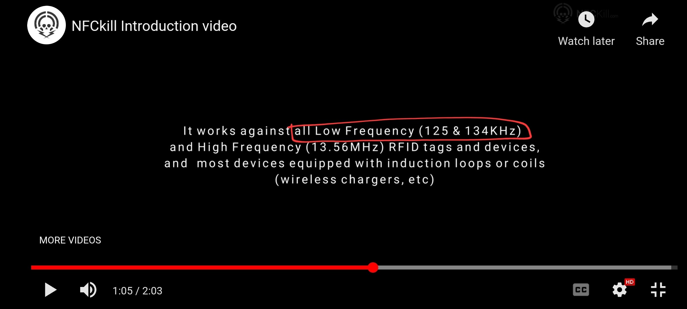

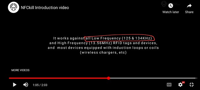

Neither an xEM nor NExT that I recall have been attempted with an NFC Kill and shared on this forum. (although LF xLED has been “killed”, see video link below)
But you may find this interesting
In short if you use NFC Kill, to fry the HF side of your NExT, you will also likely kill the LF side you want to keep.
