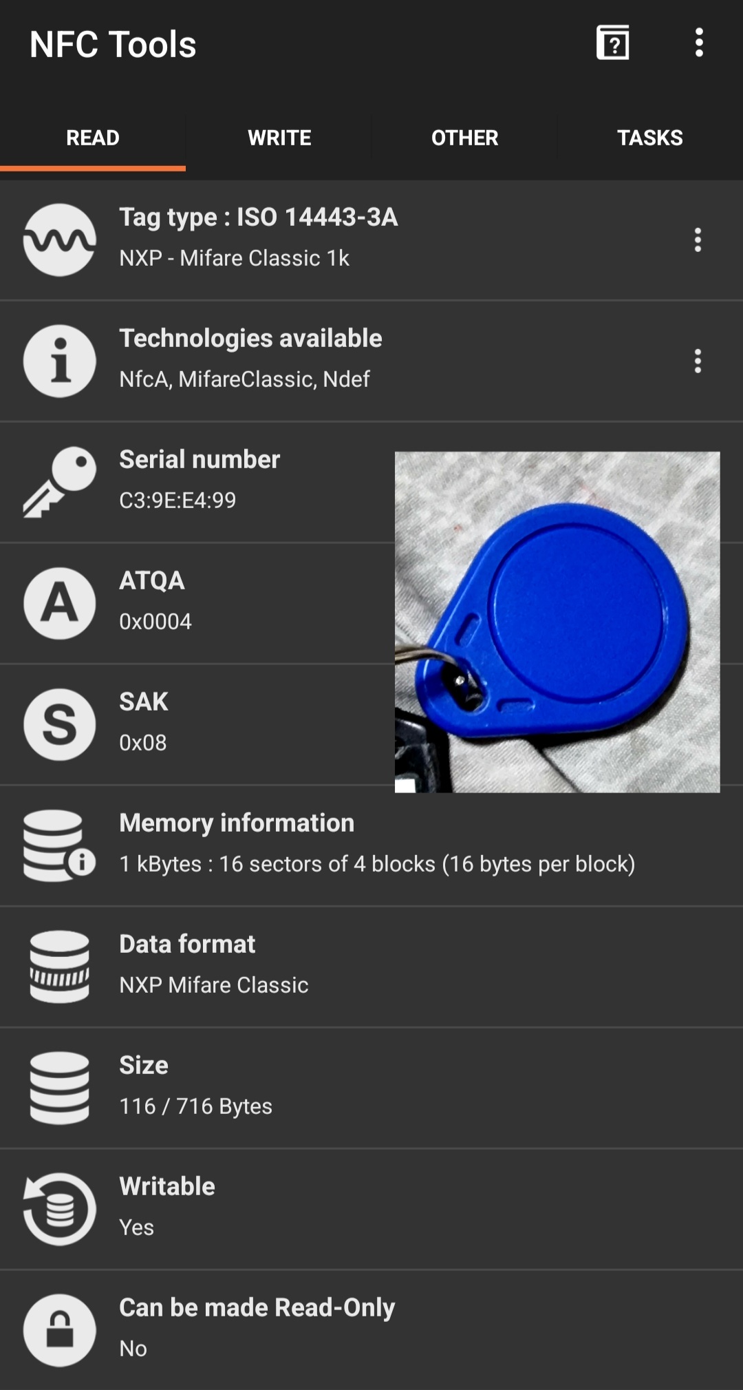

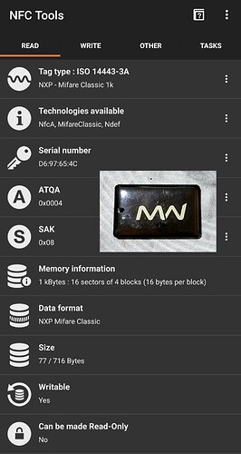

attached below are the two “existing key fob” the way they look and their specifications (which appears) upon scanning with [NFC TOOLS] which works with my apartment locks which happen to work with “mifare classic 1k”
Key fob which comes with the lock package and the specs upon scanning with “NFC TOOLS
The Generic Key fob i bought online with its specs upon scanning with “NFC TOOLS
Will getting an XM1 “Automatically” allow me to register the XM1’s ID or specification with my lock as it comes with its pre-programmed specification, or i need to still clone the existing key fob with my XM1?
Hoping it will be more of a plug and play thing though, i am basically illiterate on programming :joy:
Assuming that the XM1 has to contain some configuration then yes you should be able to just add it to the lock without setting the UID to something specific.

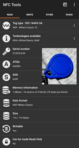

Im wondering if theres anybody iut here who has a XM1 and willing to share the screenshot or specs of his chip upon scanning thru NFC TOOLS?
Certainly, I was going to jump in and suggest 2 things.
  • NFC Tools, is great for writing data sets, but TagInfo is generally more accurate for reading chip types.
The xM1 is highly likely compatible, but the xSeries coupling is not as easy as a Flex Series.
My opinion the xM1 COULD work a FlexM1 almost certainly will.
NFC Tools scan as requested inbound, wait one…

Anyway, as we can see that particular XM1 has a UID. My Magic Ring also has a UID, so I think you would be OK just to get one and add it to the door lock.
