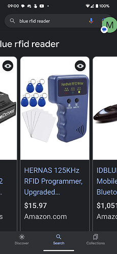

No I have not got it to work we are about to key the key fobs this week. So I don’t know I was gonna get one of the 125khz readers the little blue one…
If you’re talking about one of these
I would highly highly recommend against it. Those little blue readers can add a password to your T5577 mplant that’s can be difficult to remove, even with a proxmark
I would look into a flipper zero, or a proxmark easy

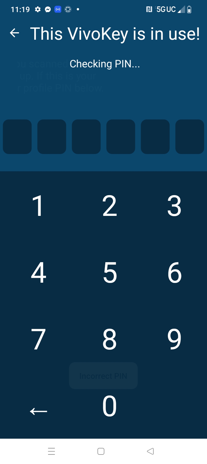

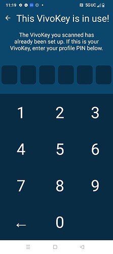

I ended up purchasing the small blue one but it never worked… and yeah long story on what happened to me though… In I love in an apartment with some family and the doors have hf and I got a next and a vivokey2 to work with only when I got to check my profile for my vivo key 2 it just says
O no I don’t know what to do. Please help how would I go about setting them in up as key as for the doors. So duh it says I forgot pin I didn’t change my pin though. Anything I can do?
Why when I use the application for vivokey2 it says enter your password then it denies me entry. Also in an I have high frequency in door in locks to my apartments and to the entrance of my in apartments. I was hoping you could in help me get my next microchip in and vivokey2 to be the door keys thanks. We have high frequency locks and key in fobs thanks. On the vivo key it says that my vivokey2 has already been set up

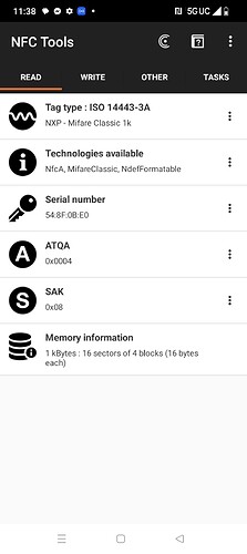

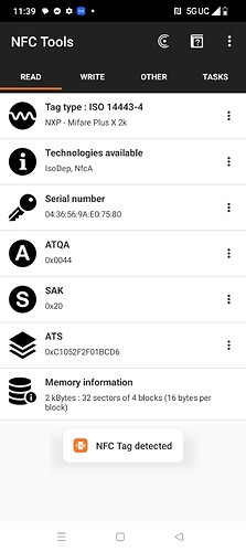

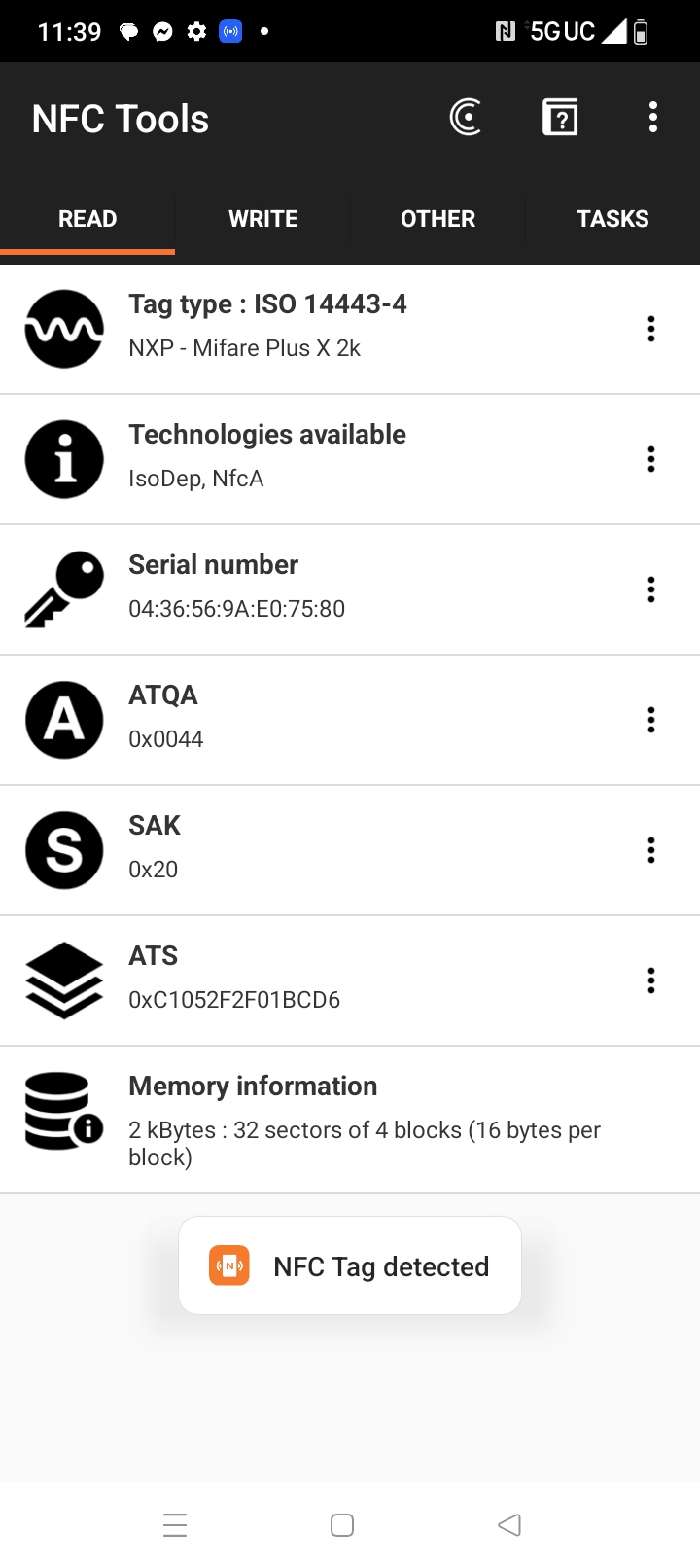

Just nfc tools
Doesn’t look like the spark 2 or next can clone that
It’s possible it could be enrolled if they are only using the UID
Look up cloning vs enrolling
you shared 3 screenshots
The first 2 appear to be the same
they are mifare classic 1k with a 4 byte NUID
this can be cloned onto an xM1, xMagic, FlexM1 etc
the last one, as Eriequiet suggested, will need to be enrolled.

Is there anyway to get on the vivokey2 platform to check what my passcode is? Because some one else had the same problem. I had phones that would work. I know for a fact I didn’t mess up my password. And there’s no way to get into my vivokey2 is there anyway to get my password back?

I need to have a xmagic for the first HF key fob and then I can have my next microchip implant for the other one as long as it’s enrolled? Or should I install two xmagics to use doors accessibly?
xMagic to copy your first one yourself (or enroll if it is easier)
and
NExT for your last one may work.
The NExT has a 7 byte UID and so does you last one, but they are different chipsets.
it will really depend on 2 things.
- Is the system just looking for a 7byte UID
- Can the readers couple with the implants
Do you have an HF xFD?
Test that on the readers to see if ot lights up
If it does, thats a good sign
If it doesn’t, it is still possible but you’ll need the implant to confirm
