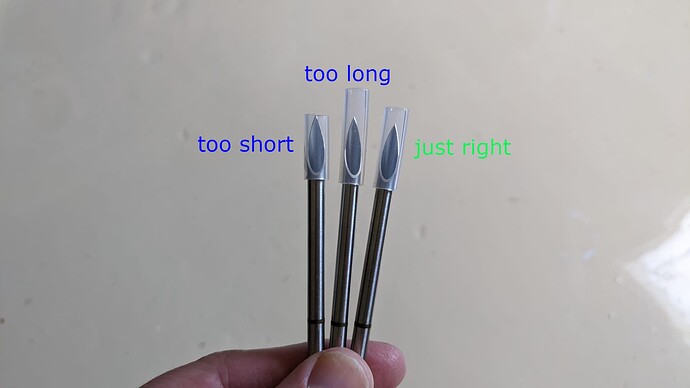

We are working on ways to include the custom 4G needle inside the same sterilization pouch as the Apex Flex. This approach appears to be industry standard for sharps - a short length of silicone tubing with the same ID as the OD of the sharp (needle in our case). The silicone material is just “grippy” enough to not fall off the needle or really move much without force being applied, while not being so tight around the needle that the sterilant can’t do it’s job.
These will be gas plasma sterilized along with the product in the same sterilization pouch, but be sequestered in its own little section of the pouch by way of strategic heat sealing… at least that’s the plan at this point.

Why is too long a problem? I would assume more is more secure?
Not yet, but “soon™”
reduces sterilant penetration by creating extra tension between tube and needle surface once sitting inside the pouch / package. Length = leverage… not that i think it would be anywhere close to a problem, but still… looking for ideal conditions.
Fair enough
