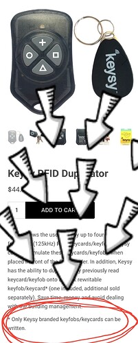

As mentioned on the other thread…
The keysy issue is twofold… I think the commercial keysy requires specially tagged or signed t5577 chips to write to… part of their revenue plan… and the other issue is the antenna.
We talked to keysy about making a special dangerous things version with a different antenna design and firmware to allow open writing to any t5577 but the per unit cost would be pretty high… might as well spend the cash on a proxmark3 rdv4…

My bad though, I should have read it fully.
The information was there, at the bottom.
