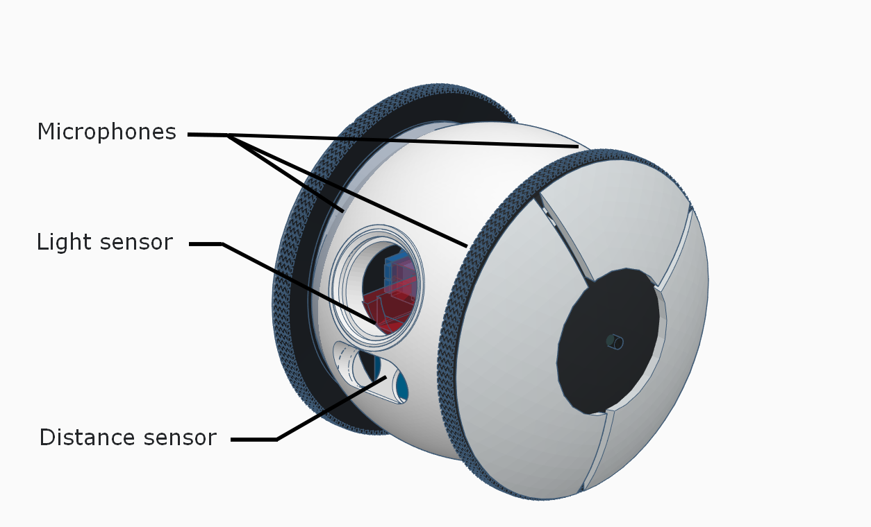

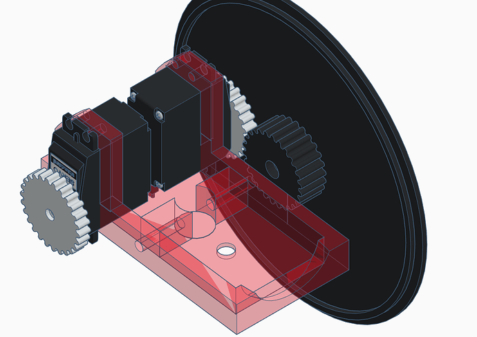

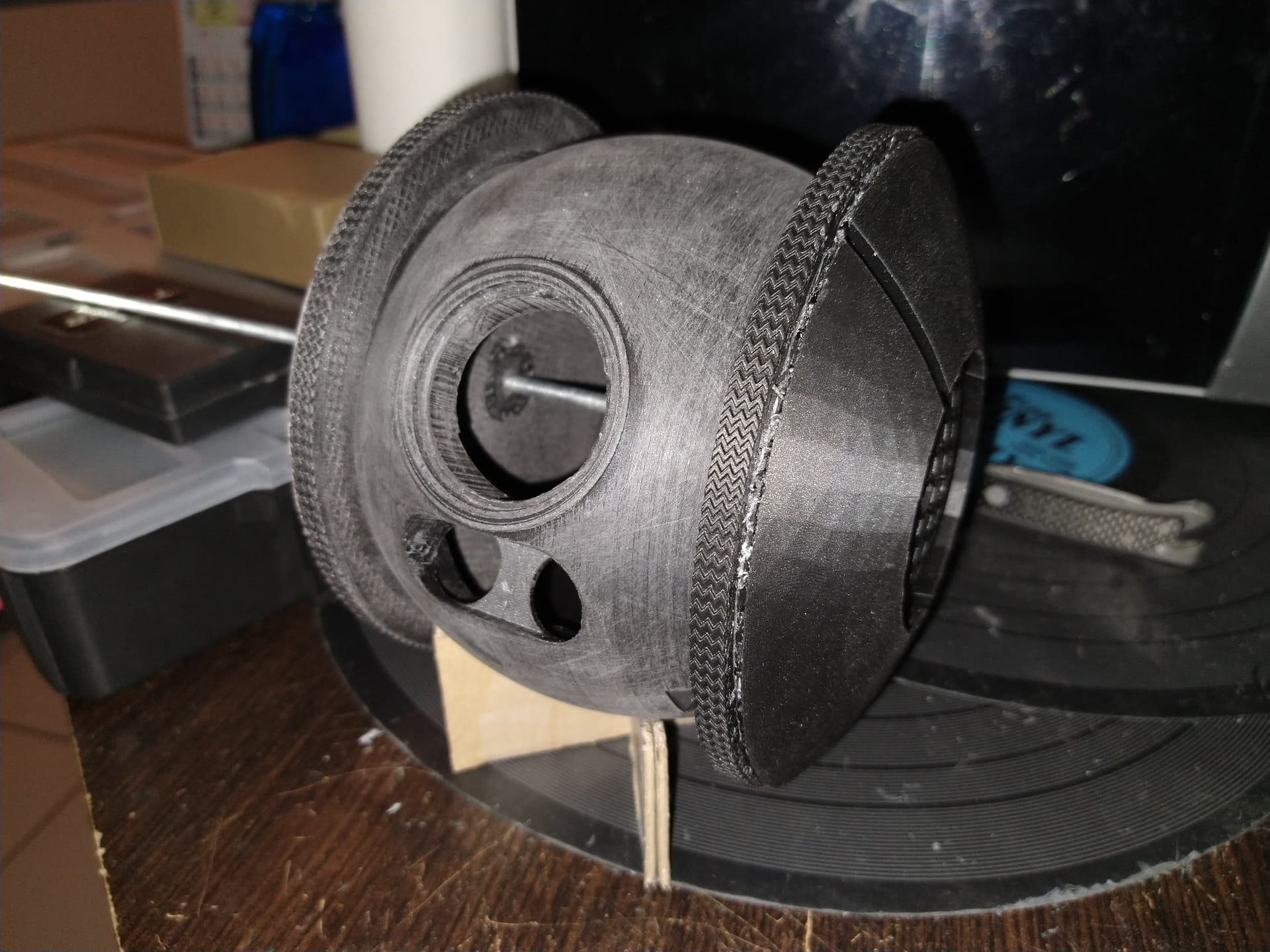

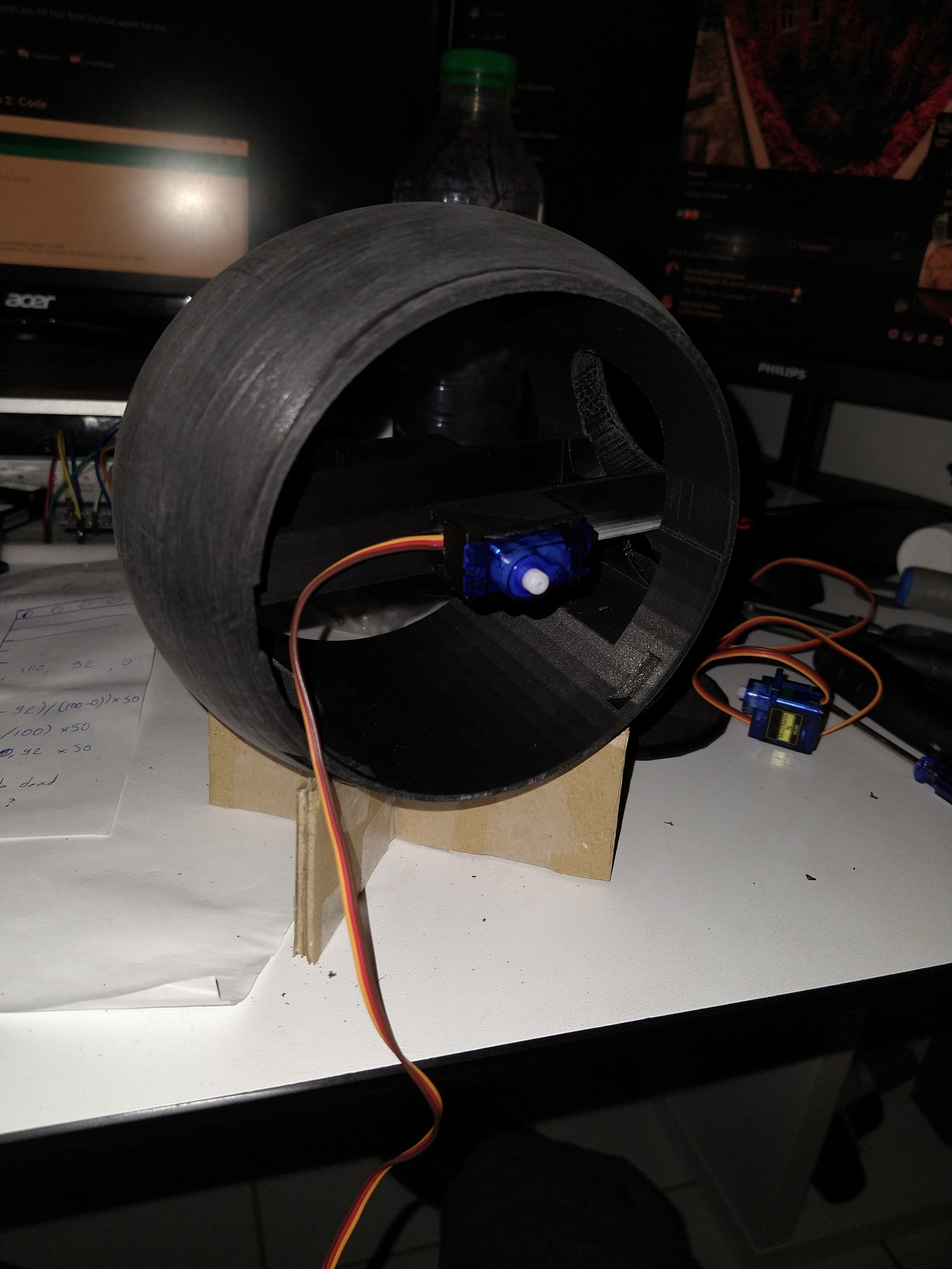

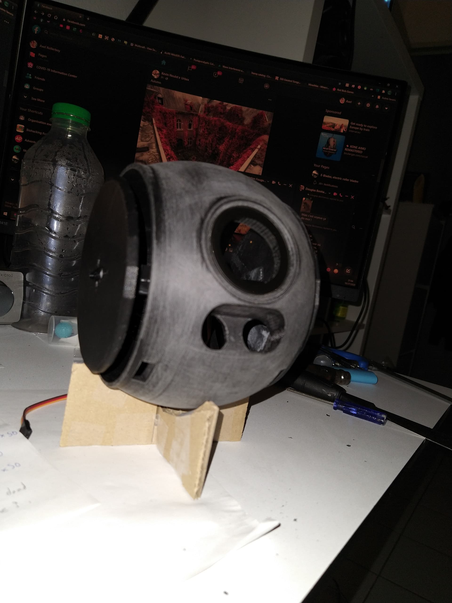

I wanted to make a bot thath follows me around and insults me like Glados back in the day. This was before AI and IOT were a thing so it was just going to be packed with sensors and work like a Roomba.
The thing that made me give up was 3D printing gears and align the wheels and the servos :rofl:
Anyway I still have some sketches and a half assembled skeleton in my boxes
Maybe that can inspire you
I actually had a pretty cool system for the eye, it was 2 axis mounted lazer pointer behind a diffuser sheet and a glass lens. I must have a video somewhere.
It could move fast so you could draw shapes and letters with it too
Hah found the eye mechanism
I wish I had a video of it behind the eye to show you the effect but it’s all long gone now

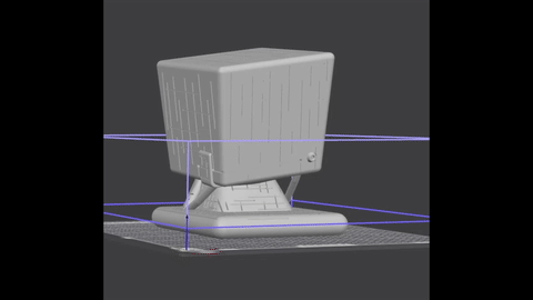

I’ve settled on and started printing a design for my assistant. This is Deep Thought from the Hitchhiker’s Guide to the Galaxy (film version). I’ve decided for now to leave her on the desktop as a static entity, but I’ve made cutouts for the eyes and the mouth to add LED strips that light up when she talks. Most of the electronic components are going inside the ‘head’ and any cables flow down the neck and out of a series of holes in the base. She’ll have two tiny PC speakers to talk with (some of the scars around the head will hollow for sound to travel) and a USB microphone input to listen to commands/wake words/etc.
Right now, I’m making it simple. I’m incorporating a DAC hat (sound) and NVME hat (storage) on an RPi 5 and loading up Home Assistant with custom wake words and a custom “depressed middle-aged British woman” voice to match the voice from the film. Trying to find ways to either 1. train an AI assistant to run offline or 2. connect the device remotely to my main PC with better hardware to drive the AI assistant. Not super sure yet.
