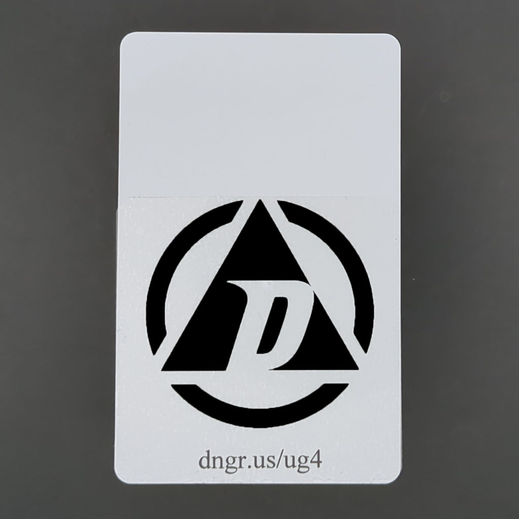

I’m not saying I always use a card first, but when its something I’m not familiar with, or if I think i have done everything correctly and not getting successful reads, I can use the card to confirm, if the reader reads the card but not the implant, then its probably a coupling issue etc.

You could however still get a test card for the ug4, and replicate the fault (if not hard bricked)
It is far easier to work with a card on a proxmark3 than one handed trying to read an implant.

This is a good call - I did get a test card pack but unfortunately did not have the foresight to include the UG4 addon. @amal if I paid to ship my implant back + extra for your time would you be able to have a look at it for me? Best case it cant be fixed and I will pay for shipping return to me (plus a test card, good idea pilgrim), worst case you have a spare ug4 do to tests on? If not I guess I will just have to bite the bullet and get a new UG4 for later :/. I think that now it is broken, to fix it would require know-how which I do not have. Let me know.
If you want us to look at it go ahead and ship it back… I won’t charge you to take a look at it. In fact it’ll probably be @tac0s doing the actual investigation. Once we figure out what the situation is, you can decide if you want it shipped back with a test card or not.
