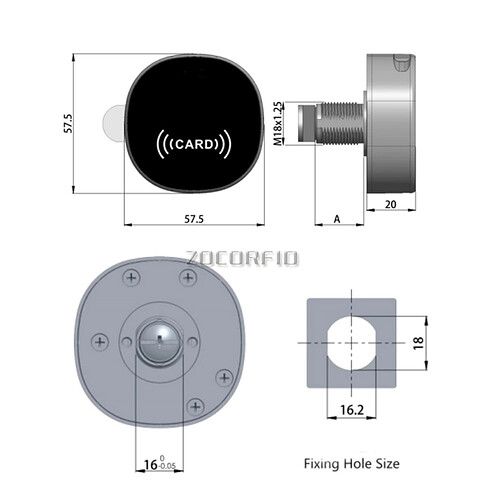

1 *lock
2 *13.56MHZ keyfob
Note:this order exclude battery.
Model:ZC-1602ID
Material: zinc alloy
Battery:CR2450(3v)
Weight:0.15KG
Working frequency:13.56MZH (M1)
1.Integrated industry advanced self-learning system RFID module.
2.User set RFID change freely. automatic save after power off.
