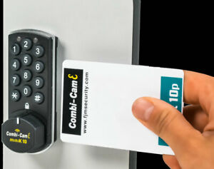

For whatever it’s worth, I ended up purchasing one of these and trying it with my xSIID. Nothing/nada/zilch…just not enough range for the xSIID to wake it up for a good read, even with a repeater. I did confirm that the lock itself would accept the NTAG I2C (as emulated at least by a Flipper), but the glassy itself couldn’t do it.
I do have a large repeater and an xM1 coming soon, will give those a go. I suspect it’s probably more of an issue with bad QC of the lock versus the one you received though.
If anyone has another recommendation for a cam-style lock that works with the small antennas in our x-series implants, please let me know. I might give Combi-Cam a shot soon.
Curious to see how much the repeater will help. I assume it will actually make the lock usable. Post an update when you figure it out!
I had to use a repeater on the Ikea Rothult lock to get it to actually read my Xsiid but i had to use a field detector to find the sweet spot for it.

Nope, I didn’t notice any mention of a reset for a lost master code or card.
I just sat here staring at my hands trying to remember which implant is in which hand.
Yeah the video says I used my right hand so that is my xEM, I couldn’t remember what that lock used. But
I seem to remember someone on here saying they changed the design since I bought one years ago.
IN any case, the reader on mine was in the knob. You’d hit a button to wake it up and it read my xEM very reliably.
