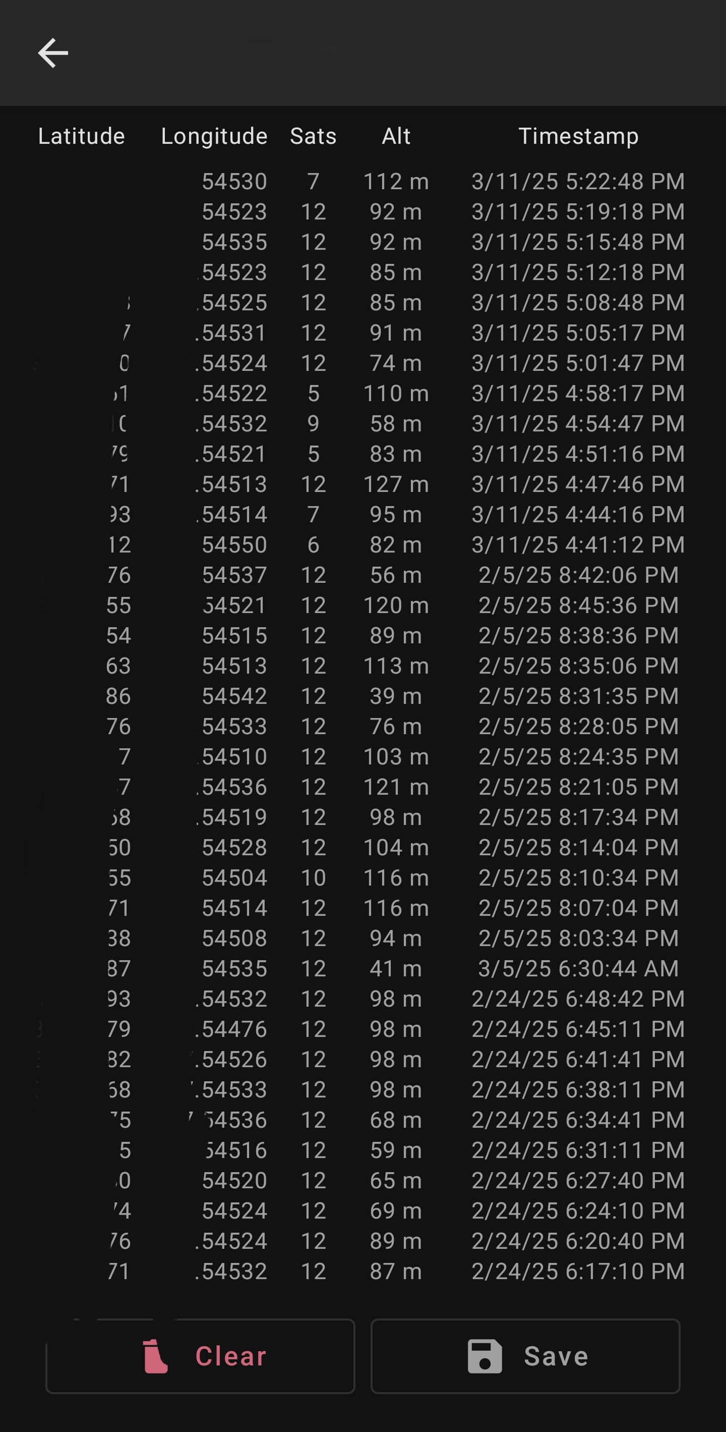

You can put it into a mode where it just constantly broadcasts gps data. Look up Meshtastic range test

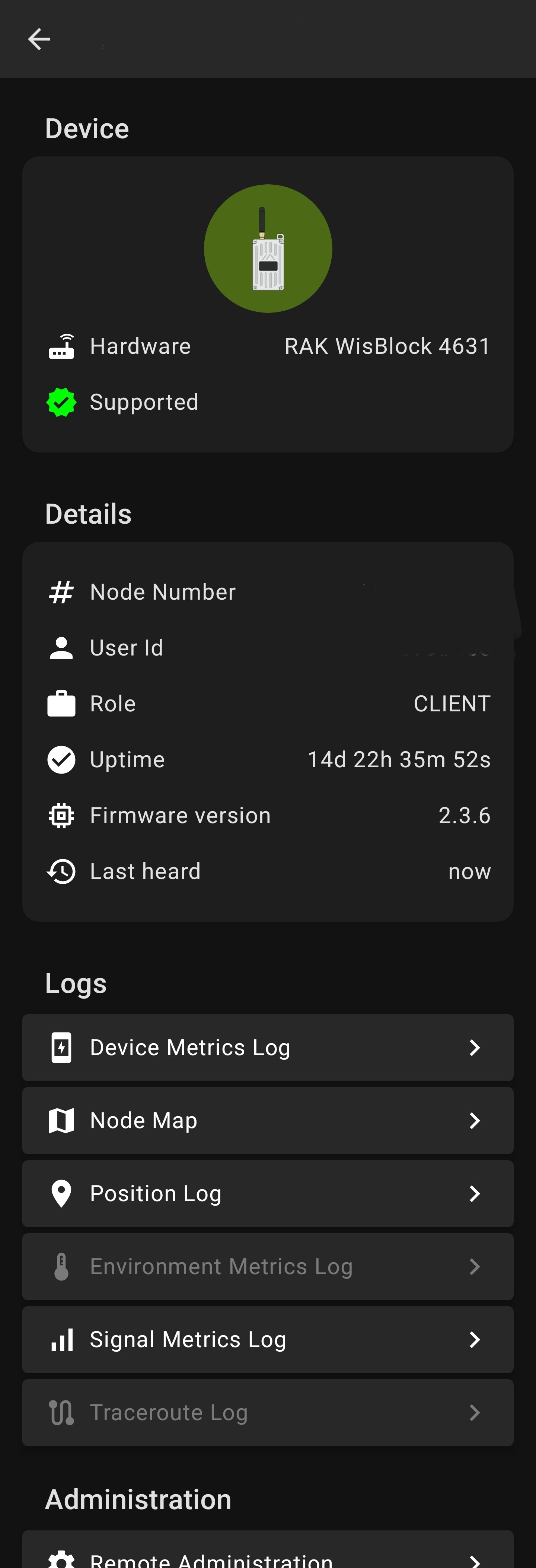

If your node has a GPS chip, then you can look at the position log.

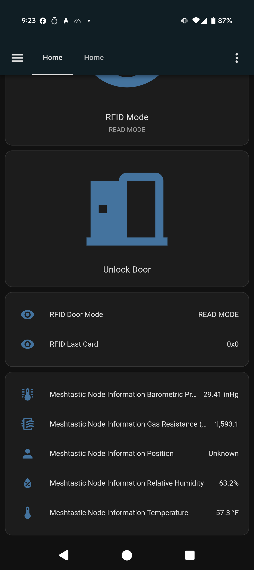

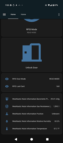

Now that I have home assistant setup I figured why not get my node info piped into it.
Really simple.
I use an NRF52 based node so I can’t use the HA tutorial on Meshtastics site as these devices have a bug outputting JSON payloads.
However I’m home assistant if you install HACS, three a Meshtastic MQTT bridge that can decide the raw protobufs data.
All you need is your local topic and your device id. Throw that info the config and enable the metrics you want.

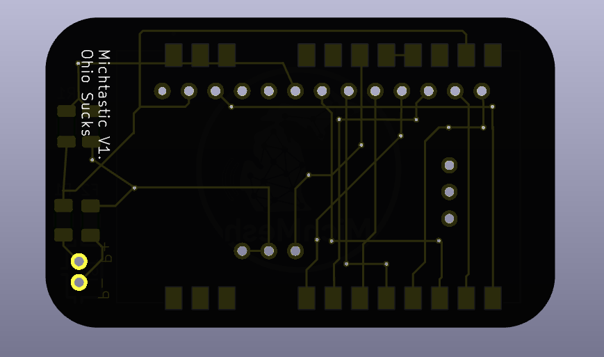

Made a crazy low cost easy to put together board for Meshtastic. Uses a Pro Micro and a E22 Lora Module.

Its pretty crazy how low powered the RAK devices are. My esp32 devices last a day. My RAK ran for a week before I plugged it back in.

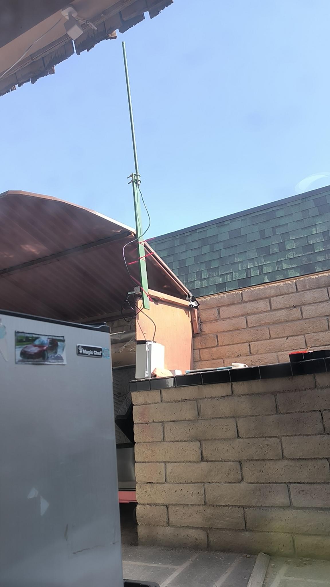

I put an antenna on my chimney but I have a 15 foot coax ran to it. It needs a box and POE module, that project got sidetracked though.
Oh definitely. 2 18650 will power a heltec for 14 hours. A wisblock 4630 for 16 days
I’ve noticed the same. My all my esp based devices last max 1 day and NRF52840 based devices last 2-6days depending on the battery size that is still smaller. T-echo lasts somewhere between 4 and 6 days and T1000-E for 2 days. In the future I’ll be getting only non-esp based devices for the battery powered versions until they improve on it.

You can pipe HA through it. The wisblock has a ton of different modules. Environmental, water detection, presence sensing.
You can set the node up to broadcast the data at intervals. HA can monitor and you can create routines based on the values.
