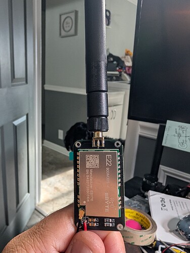

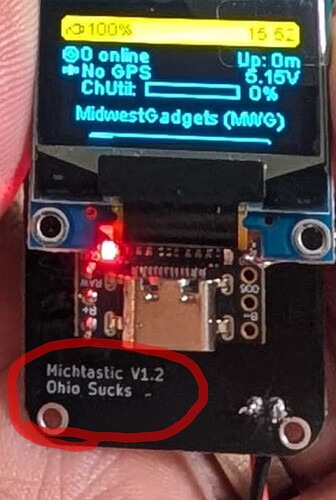

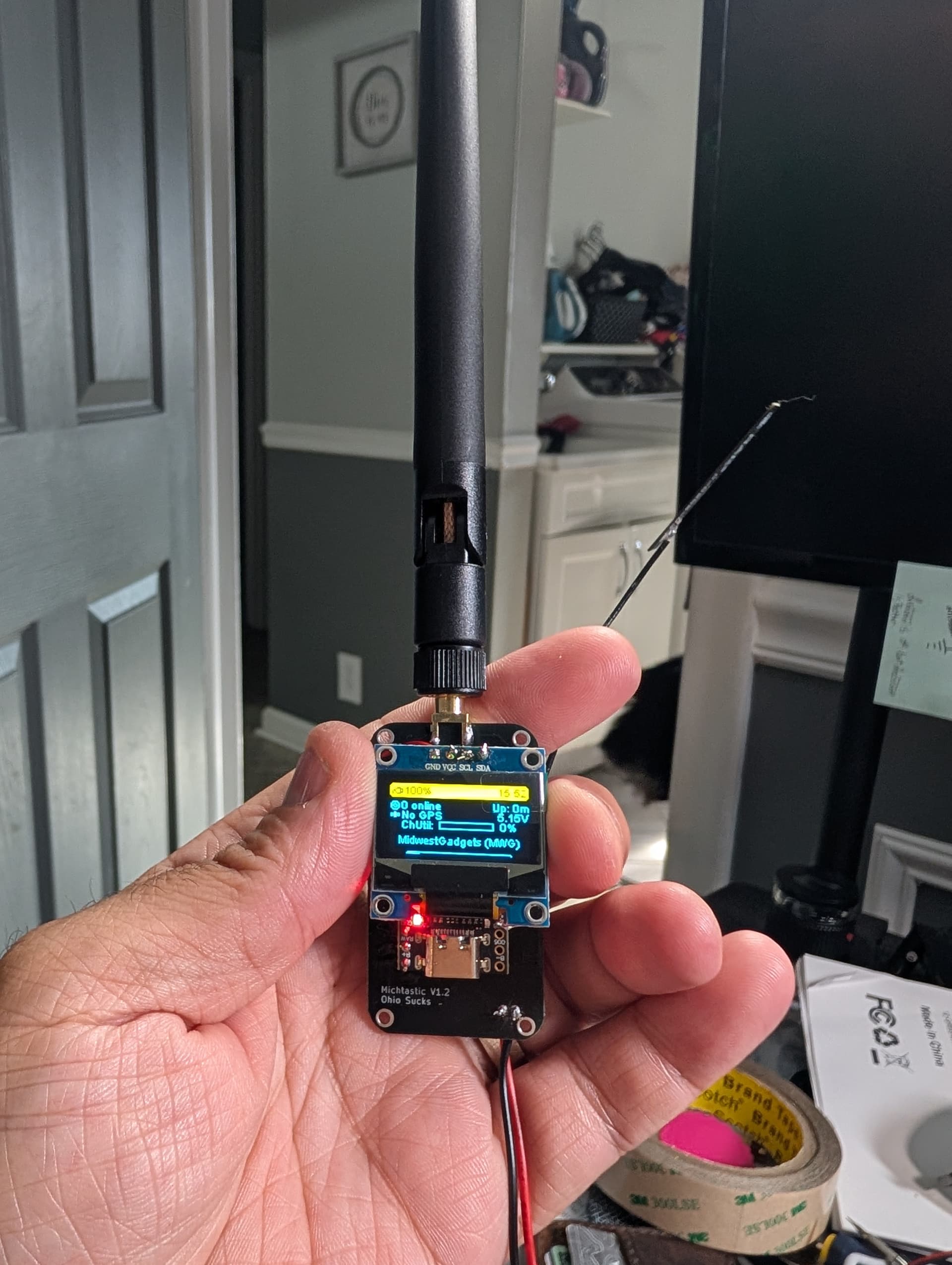

I have a few things to add, I want to put a proper charge circuit in and the screen is just test fit. But it’ll have screen support in the next build.
A gentleman of taste
I’ve gotten more positive than negative about this addition so I’m assuming it’s universally true
Let me know if you need help with this. I’m assuming that soldering SMD parts shouldn’t be a problem for you.
I need to design a charge circuit for solar and for usb-c.
USB C is easy…
How are you implementing the solar side of things? What are the specs of the panels? How much usable sun can you rely on? And for how long does it need to run when there’s no sun?
I haven’t messed with solar for a very long while. But I think that it should be relatively easy in the grand scheme of things.
I think I want the panel to charge the battery when it sees sun.
Mac panel voltage should be 12v but I also want to use 6v panels as those are cheap and easy to come by
