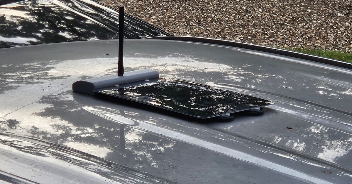

Has anyone built one of these solar car nodes?
I want to build one but the instructions don’t explain everything
What bit do you need clarification on?, I haven’t built one, but I had a quick look through and it all seemed to make sense to me, but I might have missed something…
The hive mind might have answers…
I’m just an idiot :sweat_smile: I misread the section about the screws and found another answer buried in the comments about the usb wiring
I appreciate you offering to help!
No it’s very straight forward.
It’s just a shell to hold the rak device and secures onto a panel.
Yeah I misread the section about the screws. I also didn’t know which wires of the four inside the USB cable to use but it was answered in the comments section :sweat_smile:
don’t be too hard on yourself, the comment sectio. is not where instructions should be…
