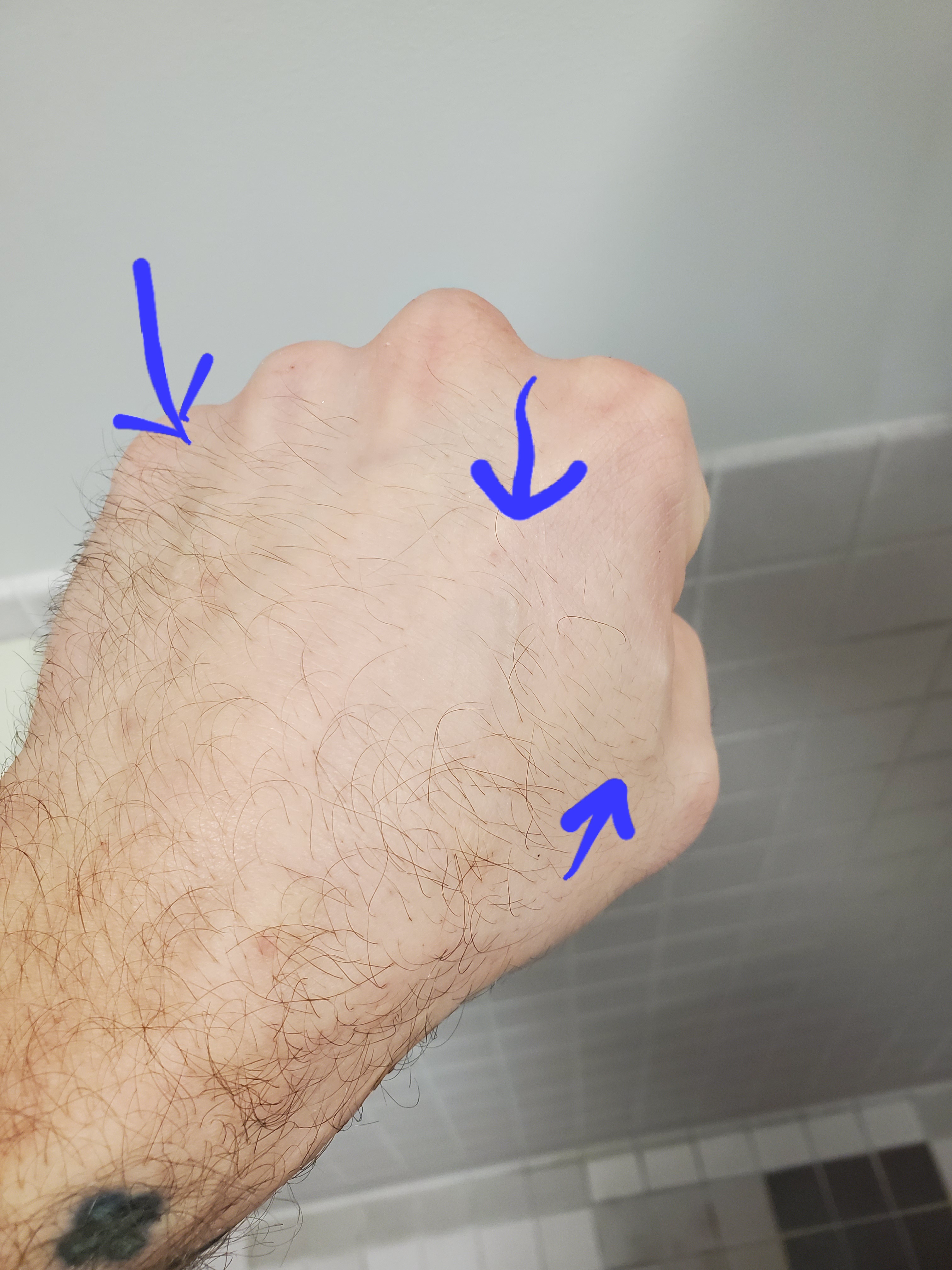

You could try holding a golf ball/paperball/sock or something similar as hard as you can in your hand. It will help “push” the implant to the surface.
My implant there isn’t the easiest to see or feel if you didn’t know it was there. This brings it to the surface

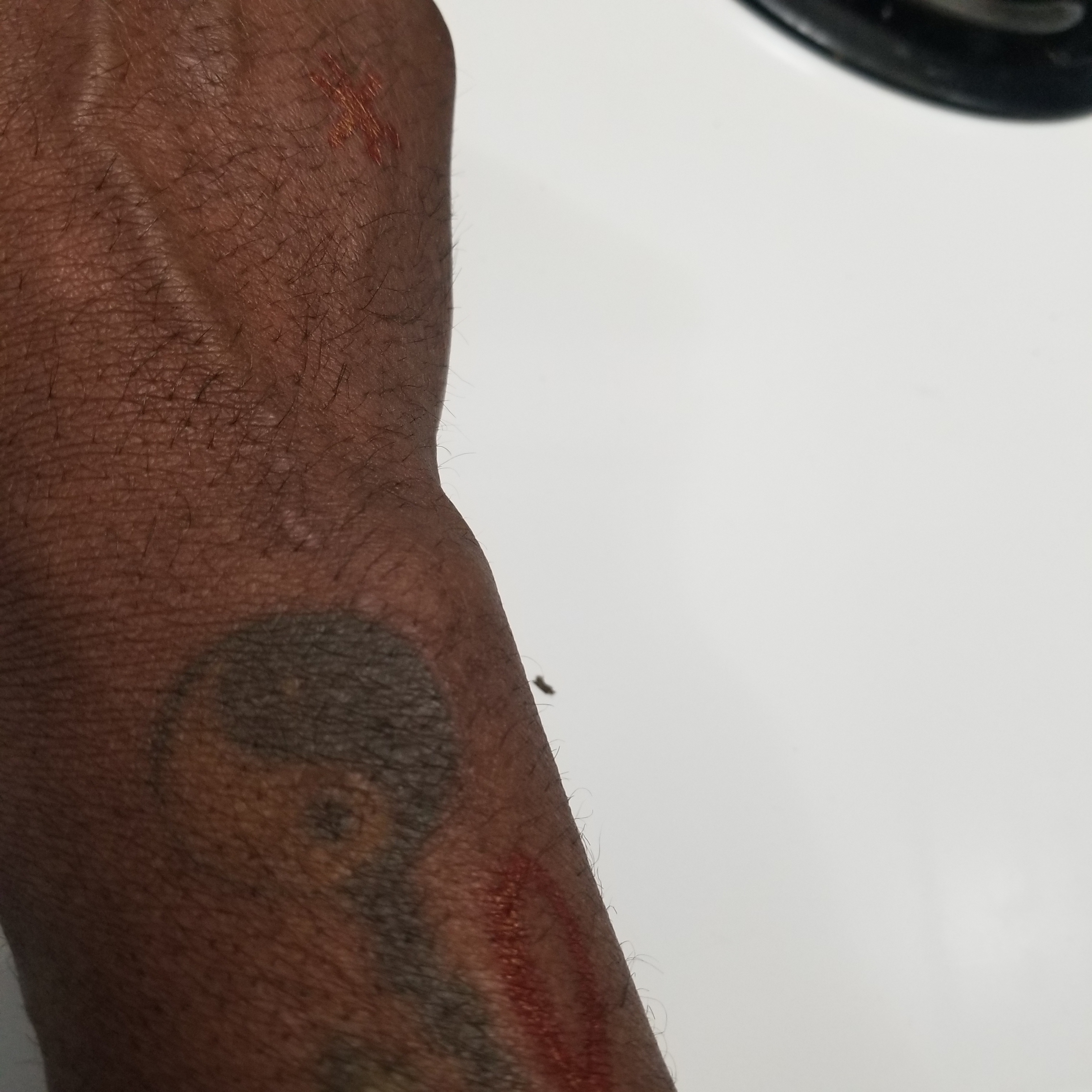

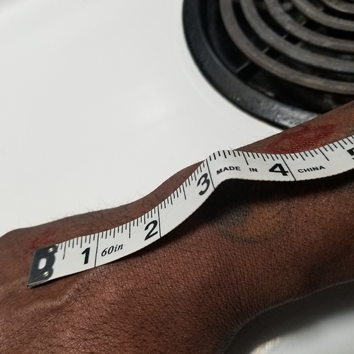

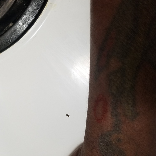

Thanks everyone for your replies and suggestions I located the chip and it has migrated from R4 position to middle of my forearm. That’s a 6 inch (15cm) migration and the second chip that I have implanted that migrated from its original location
My understanding is that unless your phone memory is stored on floppy disks, your phone is pretty safe too. Your compass won’t point the right way while near the field though.
Glad you found it. May I see a picture of where it went in and where it is please?
I think it would be nice to have it documented someplace on this site.
“May I see a picture of where it went in and where it is”- sure thing. I’m just getting back home so give me a few minutes and I’ll take some pictures as best as possible
