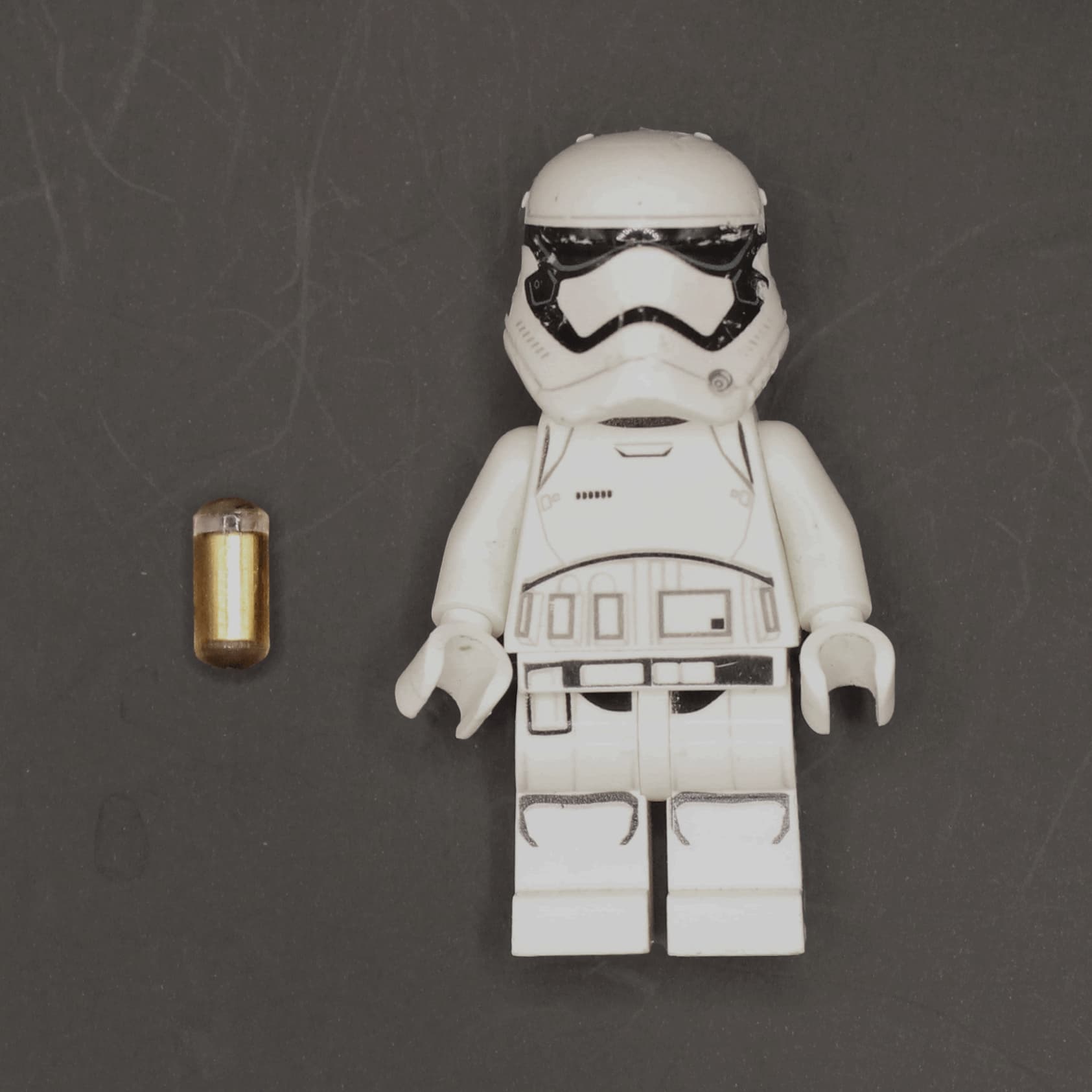

M0490a now available!
The m0490a is an 4mm axially magnetized cylinder 9mm in length with a 3x6mm n52 core. If you’re looking for something sense-y, this is probably not the one for you. At nearly .4 grams, it’s a about 2x as heavy as the m0426a with a field strength measured at ~1450 G (compared to the ~2100 G of the former), in short, that’s a lot to over come without much power. But it does feature dramatically more surface area for lifting shenanigans.
If this isn’t the magnet you’re looking for–no worries! We’ve got some other exciting options in the pipe: m1147a (FS 2900 G, 2g) and m0420a.
