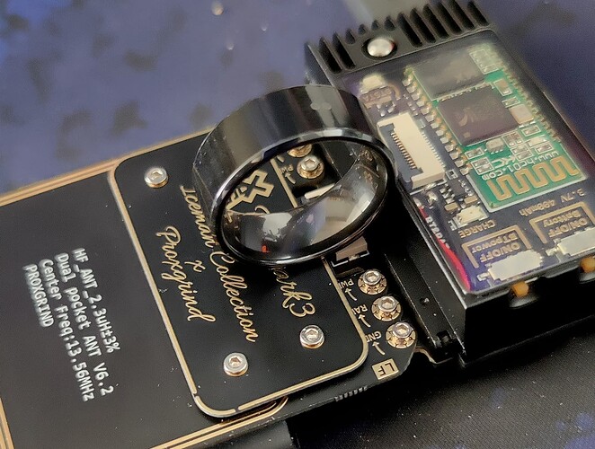

can you show a picture of how the ring is placed on the proxmark3? in short the dot should be facing down overtop the red ring.
with that positioning, try first cloning it into EM mode with lf em 410x clone --id 0102030405 and run that a few times… then lf search it.

Do you have a low frequency antenna? Have you set the switches appropriately? All I see in that picture is a high frequency antenna.
From other photos I found it looks like there are tuning switches on the underside. How are they set? (Can you see where the actual coil is in that antenna pack?)
Yeah, Thats the RDV4 antenna layout, he has it sitting on it over the LF antenna trace
Correct, on the newer Versions, there is a Q switch, you can toggle between 125 and 134kHZ, also 2 options, that would be worth trying
7 for accuracy and 14 for range

paste a picture, fir simple people like myself
Yep
Switches are set to f125, and q7
Have you tried q14?
Yeah same result but it seems way finickier to get a read, with q14 the ring goes between not finding a LF tag and getting indala without moving it
Sounds a lot like this post:
No go as well, starting to think the LF on the ring is just busted
