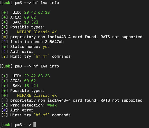

[usb] pm3 → hf search
:one_o_clock: Searching for ISO14443-A tag…
[+] UID: 29 42 6C 3B
[+] ATQA: 00 02
[+] SAK: 18 [2]
[+] Possible types:
[+] MIFARE Classic 4K
[=] proprietary non iso14443-4 card found, RATS not supported
[+] Prng detection: weak
[#] Auth error
[?] Hint: try hf mf commands
[+] Valid ISO 14443-A tag found

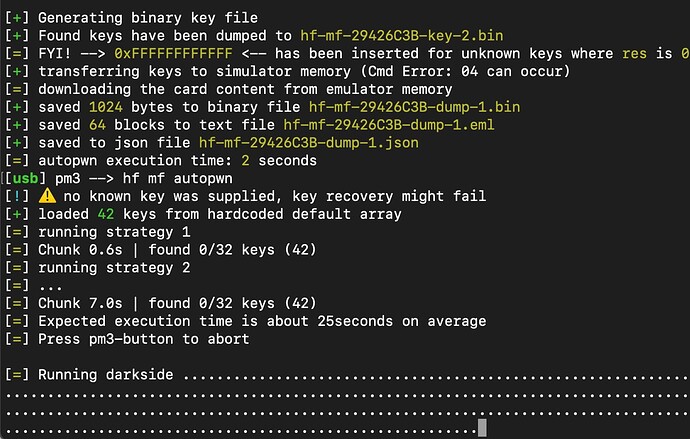

[usb] pm3 → hf mf nested --4k --blk 0 -a -k FFFFFFFFFFFF --d
[+] Testing known keys. Sector count 40
[=] Chunk 1.8s | found 75/80 keys (43)
[+] Time to check 42 known keys: 2 seconds
[+] enter nested key recovery
[+] Found 3 key candidates
:three_o_clock: 0/3 keys | 17.8 keys/sec | worst case 0.2 seconds remaining
[+] target block 176 key type B
[+] target block 192 key type B
[+] Found 1 key candidates
[+] target block 192 key type B – found valid key [ 7F33625BC129 ]
[=] Chunk 0.7s | found 5/80 keys (1)
[+] time in nested 18 seconds
[=] trying to read key B…
[+] found keys:
[+] | Sec | key A |res| key B |res|
[+] | 000 | ffffffffffff | 1 | ffffffffffff | 1 |
[+] | 001 | ffffffffffff | 1 | ffffffffffff | 1 |
[+] | 002 | ffffffffffff | 1 | ffffffffffff | 1 |
[+] | 003 | ffffffffffff | 1 | ffffffffffff | 1 |
[+] | 004 | ffffffffffff | 1 | ffffffffffff | 1 |
[+] | 005 | ffffffffffff | 1 | ffffffffffff | 1 |
[+] | 006 | ffffffffffff | 1 | ffffffffffff | 1 |
[+] | 007 | ffffffffffff | 1 | ffffffffffff | 1 |
[+] | 008 | ffffffffffff | 1 | ffffffffffff | 1 |
[+] | 009 | ffffffffffff | 1 | ffffffffffff | 1 |
[+] | 010 | ffffffffffff | 1 | ffffffffffff | 1 |
[+] | 011 | ffffffffffff | 1 | ffffffffffff | 1 |
[+] | 012 | ffffffffffff | 1 | ffffffffffff | 1 |
[+] | 013 | ffffffffffff | 1 | ffffffffffff | 1 |
[+] | 014 | ffffffffffff | 1 | ffffffffffff | 1 |
[+] | 015 | ffffffffffff | 1 | ffffffffffff | 1 |
[+] | 016 | ffffffffffff | 1 | ffffffffffff | 1 |
[+] | 017 | ffffffffffff | 1 | ffffffffffff | 1 |
[+] | 018 | ffffffffffff | 1 | ffffffffffff | 1 |
[+] | 019 | ffffffffffff | 1 | ffffffffffff | 1 |
[+] | 020 | ffffffffffff | 1 | ffffffffffff | 1 |
[+] | 021 | ffffffffffff | 1 | ffffffffffff | 1 |
[+] | 022 | ffffffffffff | 1 | ffffffffffff | 1 |
[+] | 023 | ffffffffffff | 1 | ffffffffffff | 1 |
[+] | 024 | ffffffffffff | 1 | ffffffffffff | 1 |
[+] | 025 | ffffffffffff | 1 | ffffffffffff | 1 |
[+] | 026 | ffffffffffff | 1 | ffffffffffff | 1 |
[+] | 027 | ffffffffffff | 1 | ffffffffffff | 1 |
[+] | 028 | ffffffffffff | 1 | ffffffffffff | 1 |
[+] | 029 | ffffffffffff | 1 | ffffffffffff | 1 |
[+] | 030 | ffffffffffff | 1 | ffffffffffff | 1 |
[+] | 031 | ffffffffffff | 1 | ffffffffffff | 1 |
[+] | 032 | ffffffffffff | 1 | ffffffffffff | 1 |
[+] | 033 | ffffffffffff | 1 | ffffffffffff | 1 |
[+] | 034 | ffffffffffff | 1 | ffffffffffff | 1 |
[+] | 035 | 6a1987c40a21 | 1 | 7f33625bc129 | 1 |
[+] | 036 | 6a1987c40a21 | 1 | 7f33625bc129 | 1 |
[+] | 037 | 6a1987c40a21 | 1 | 7f33625bc129 | 1 |
[+] | 038 | 6a1987c40a21 | 1 | 7f33625bc129 | 1 |
[+] | 039 | 6a1987c40a21 | 1 | 7f33625bc129 | 1 |
[+] ( 0:Failed / 1:Success )
[+] Generating binary key file
[+] Found keys have been dumped to hf-mf-29426C3B-key.bin
[=] FYI! → 0xFFFFFFFFFFFF ← has been inserted for unknown keys where res is 0

[usb] pm3 → hf mf dump
[=] Using hf-mf-29426C3B-key.bin
[=] Reading sector access bits…
[+] Finished reading sector access bits
[=] Dumping all blocks from card…
[+] successfully read block 0 of sector 0.
[+] successfully read block 1 of sector 0.
[+] successfully read block 2 of sector 0.
[+] successfully read block 3 of sector 0.
[+] successfully read block 0 of sector 1.
[+] successfully read block 1 of sector 1.
[+] successfully read block 2 of sector 1.
[+] successfully read block 3 of sector 1.
[+] successfully read block 0 of sector 2.
[+] successfully read block 1 of sector 2.
[+] successfully read block 2 of sector 2.
[+] successfully read block 3 of sector 2.
[+] successfully read block 0 of sector 3.
[+] successfully read block 1 of sector 3.
[+] successfully read block 2 of sector 3.
[+] successfully read block 3 of sector 3.
[+] successfully read block 0 of sector 4.
[+] successfully read block 1 of sector 4.
[+] successfully read block 2 of sector 4.
[+] successfully read block 3 of sector 4.
[+] successfully read block 0 of sector 5.
[+] successfully read block 1 of sector 5.
[+] successfully read block 2 of sector 5.
[+] successfully read block 3 of sector 5.
[+] successfully read block 0 of sector 6.
[+] successfully read block 1 of sector 6.
[+] successfully read block 2 of sector 6.
[+] successfully read block 3 of sector 6.
[+] successfully read block 0 of sector 7.
[+] successfully read block 1 of sector 7.
[+] successfully read block 2 of sector 7.
[+] successfully read block 3 of sector 7.
[+] successfully read block 0 of sector 8.
[+] successfully read block 1 of sector 8.
[+] successfully read block 2 of sector 8.
[+] successfully read block 3 of sector 8.
[+] successfully read block 0 of sector 9.
[+] successfully read block 1 of sector 9.
[+] successfully read block 2 of sector 9.
[+] successfully read block 3 of sector 9.
[+] successfully read block 0 of sector 10.
[+] successfully read block 1 of sector 10.
[+] successfully read block 2 of sector 10.
[+] successfully read block 3 of sector 10.
[+] successfully read block 0 of sector 11.
[+] successfully read block 1 of sector 11.
[+] successfully read block 2 of sector 11.
[+] successfully read block 3 of sector 11.
[+] successfully read block 0 of sector 12.
[+] successfully read block 1 of sector 12.
[+] successfully read block 2 of sector 12.
[+] successfully read block 3 of sector 12.
[+] successfully read block 0 of sector 13.
[+] successfully read block 1 of sector 13.
[+] successfully read block 2 of sector 13.
[+] successfully read block 3 of sector 13.
[+] successfully read block 0 of sector 14.
[+] successfully read block 1 of sector 14.
[+] successfully read block 2 of sector 14.
[+] successfully read block 3 of sector 14.
[+] successfully read block 0 of sector 15.
[+] successfully read block 1 of sector 15.
[+] successfully read block 2 of sector 15.

I used autopwn to crack the fob, and seem have the dump and key binary files. Did you ever figure this out?
I’ve been using the commands recommended from the Proxmark repo such as:
hf mf wrbl --blk 0 -k FFFFFFFFFFFF -d 11223344440804006263646566676869
But no luck.

Hey, thanks for replies!
Just in case, here’s a screen cap of hf 14a info
This is for a blank card. I can successfully (I think) write to block zero, and the UID matches the fob I’m trying to clone.
What fails (as the OP has a similar command) is this command:
hf mf restore --4k -f [original_dump.bin] -k [gen2_magic_card_key.bin]
Thanks!

mifare classic 1k and 4k 7byte uid changable does exist in both g1 and g2 forms, what told you otherwise?
Fair point.
I should have said
Possibly not…
I do actually have a couple cards of each,
Both s70s rather than S50s
and they read as Gen3
I know yall are looking at two people problems now but they are related so ill post my output as well. The first info is from my card im trying to clone to and the second info is from the source key fob. Like @cerulean im failing on the restore.
ok so the uid is changed thats good
hf mf autopwn them both
hf mf restore -f olddump.bin -k newkeyfile.bin
Sorry you lost me. Do you need to autopwn both the original fob and the new card? I had just been doing the original fob. Whats olddump.bin in this context and is newkeyfile.bin the key output given from autopwn on the original fob?
ok so you will be autopwning both cards. the card youre cloning from and card youre cloning to. ill call these cardfrom and cardto respectivelt
autopwn both
hf mf restore -f cardfrom -k cardtokey.bin
you need the keyfile of the card youre writing to, to write to or else it will fail
Do I need to supply the cardto with a key? Cardfrom autopwn works fine but cardto autopwn seems to be struggling
autopwn is for getting the keys so you cant supply it with a key you dont have lol.
youll need to let cardto crack by autopwn and if it doesnt crack on autopwn you may have fuckd it by uploading unknown keys to it
