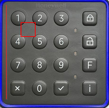

Where have you placed the sticker?
Sad to hear that it doesn’t work with readers with keypads.
The readers without keypads even work quite well with the implant without the stickers.

I tested several spots on the reader. It worked best between 1-2 and 4-5. It also worked with the sticker there, but only 2 times out of 20 attempts. The signal is strongest on the left side of the reader. (Tested with the X Field Detector)
