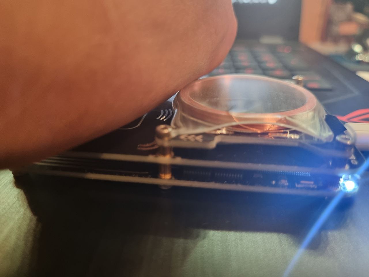

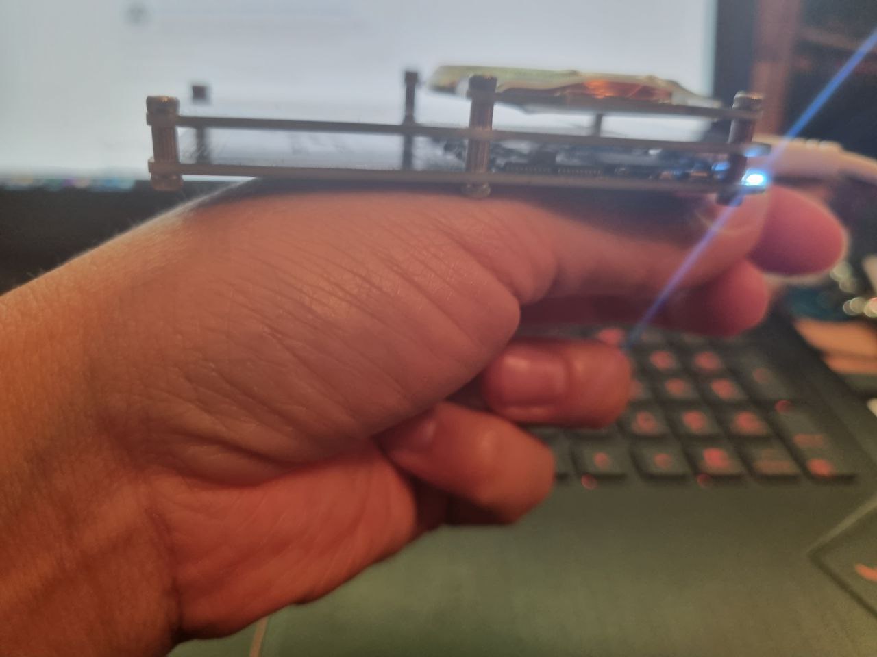

OK, THESE positions below are the ones you want to be trying, NONE of the others
Ideally, where you see the Antenna trace on the bottom board, you want to place that perpendicular to your implant, making a “+” with antenna and implant.
Try an hf tune , and record the higest voltage with your implant away from the antenna, then place your antenna on the implant, and move it around until you get the lowest possible Voltage ( record this voltage also). This SHOULD be your best coupling and therefore your best chance of reading / writing to your implant.
once you have the LOWEST voltage, DO NOT MOVE, send an hf search in that position and orientation, if it doesn’t work Keep pressing firmly, and move VERY small increments after each command until you get a read
let us know how this goes.
It may also hep to draw an outline around your xSIID
Since your phone makes your blinky blink? ![]()
the hf tune should also make your LED blinky blink
and at its brightest, is also likely where you should be able to get a read.
From reading your posts above, it sounds like there is some reconfiguring to do, but we need to get a read before we can tackle that issue
Basically it looks almost like the implant is going to be sitting near the center of the bottom PCB and that’s not where it should be. The trace of the hf antenna runs under half the bottom PCB (the half on the other side from the USB cable connector). The very end of the PCB have HF traces across it, so the very end of the proxmark should be sitting across your xSIID so half the xSIID is peaking out from under the bottom PCB of the proxmark… if that makes sense.
