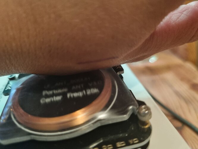

The line is where the implant is
Trying one side
Trying the other side
that is the LF antenna you are using, you want to use the other antenna on there, the flat black part
Yes, I tried both antennas the LF and the HF. For HF I tried top and bottom of the reader.
