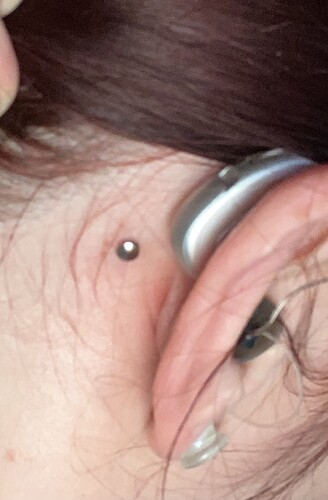

It’s interesting that placing the headphones over my titanium dermals does offer a slightly higher amplification. I got them placed at the TE18 acupuncture points. I can’t do a lot with them yet, as they aren’t healed long enough to play with with, however I have a theory that if I place several titanium dermals at certain locations, I could use multiple headphone parts to place over them. What they lack in magnetism, they make up for in vibration.

When I receive it, I’m going to try something; I’m going to get basic round bandages and see what happens when I press the magnet against the dermal. The dermal sits right on the bone. Only if it works, I will add a series of dermals to key locations.
That’s a smart idea. Too bad the dermals are not a ferromagnetic material that the magnet can stick directly to (can’t be or they would rust from contact with your juices). I’ve also heard that hanging things off of dermals is a bad idea, because the skin is the only support and it gets irritated.
I don’t know if this will be beneficial. Try the two magnets that are included with the kit at different spots and see if you get better results than just one. My thought is that the field only has so much energy to impart to the magnets, and if you place several then each will get a smaller vibration and you’ll get diminishing returns.

I’ve seen ones that are just a post and others that have a threaded head that comes apart. That still wouldn’t remove the issue of hanging weight off of the dermal and causing irritation. You also couldn’t screw the dermal directly into the magnet, so you would have to affix it with some kind of adhesive. Then you introduce potential skin irritation from the adhesive and potentially muffle the vibrations because the magnet and dermal are no longer in direct contact.

I won’t hang anything in them. If I go that route, it would be adhesive bandage to the area.
