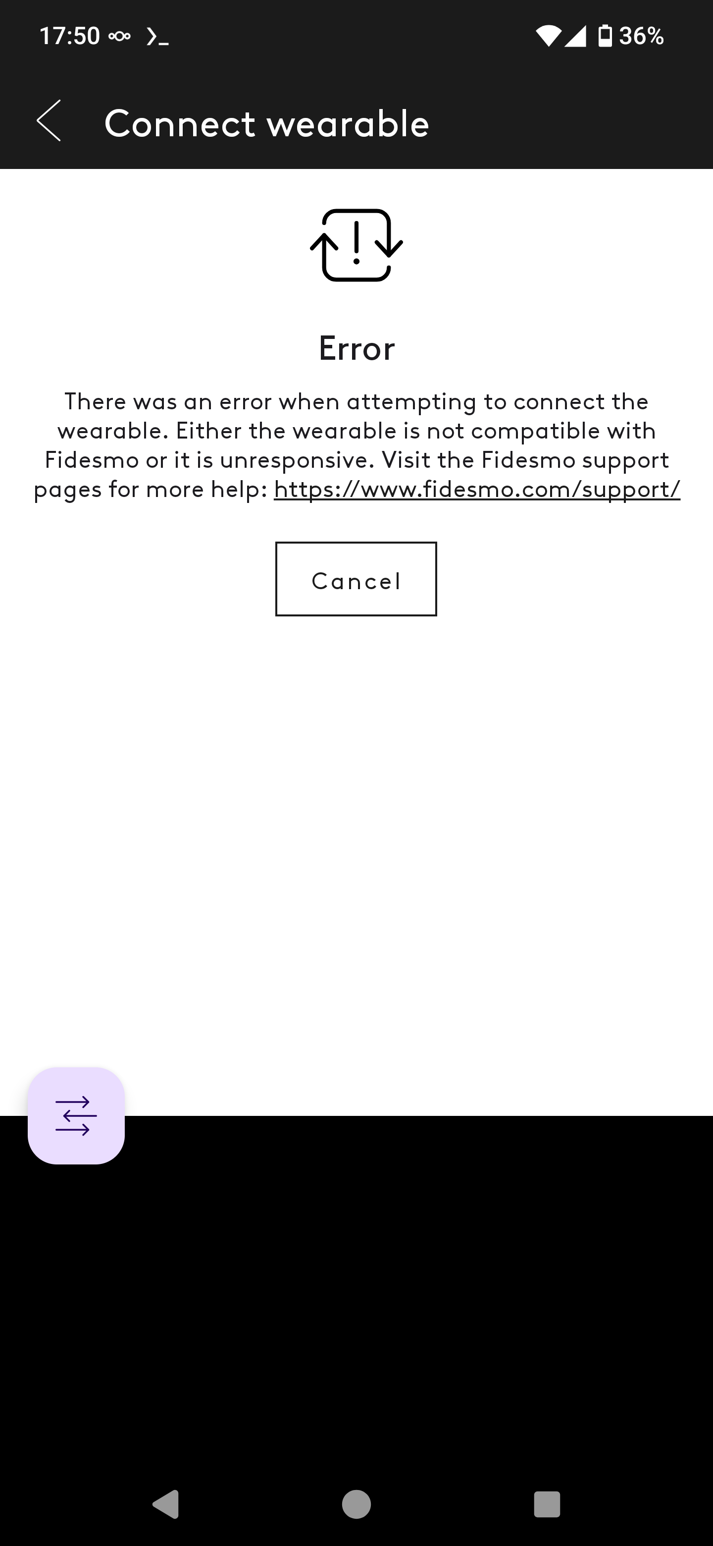

New apex flex install: Fidesmo won't connect and everything is greyed out in Apex Manager
Even though I tried to enable debug logging in fidesmo, I don’t see any logs. In apex manager I tried to “export logcat” and it says “Logcat exported to documents folder” but I don’t see any files in the documents folder, only folders for other stuff
ok so… it appears that a batch of Apex have gone out without the final provisioning step… luckily this is easily fixed… it’s a bit unorthodox but easily fixable. Send me a DM and get yourself an Android phone you can load this on;
Go into settings and configure it like this;
Then send me a DM so we can coordinate the fix :slight_smile:
