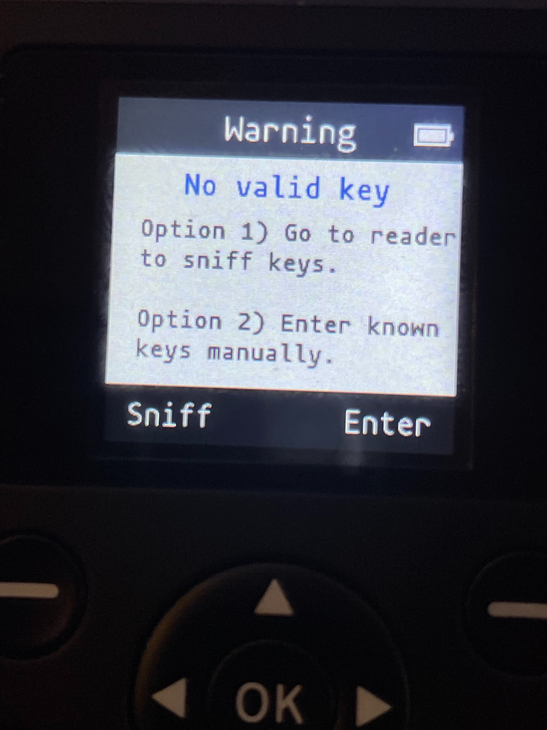

But now ive been able to fairly consistently get a read on the lf chip. However after it reads the chip, it immediately starts checking for keys and then pops up with a “No Valid Key”. Then gives me the option to try to sniff a key, or to enter one manually.
Is this telling me the chip is blank at the moment and i need to write one? or is there some other key necessary to write to the chip and this is why it’s failing? im not finding much on these forums or google about “No Valid Key” issues.

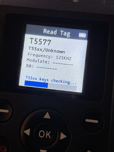

1 - lf tune seems to detect the chip as the mV drops. and I know when i hit that spot, I can;
2 - access the icopy-xs main menu, click on “Read Tag” and select “t5577”, and it will detect a t55xx/unknown chip
3 - Immediately after detecting the tag it tries to check for keys. Which always fails
4. If i select any other chip type to try and read, eg em410x - it says no tag found or wrong type found.
Attaching pictures of the icopy-xs just in case something there means something to someone…
