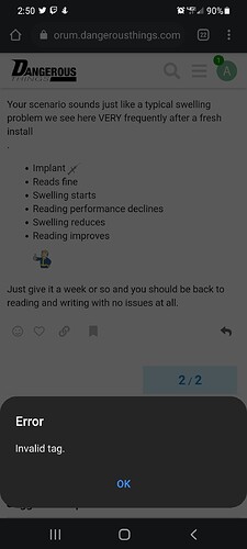

I just got an implant the other day, and it won’t scan right. It worked like a charm the first few times, but now all I get is error: invalid tag on my phone. NXP taginfo can see my chip and read it, but no other app, not even tagwriter or the DT app can access or change the info.

I have the NExT rfid plus nfc chip. Neither DT app will work. I used nfc tools plus to write onto the chip, and I could scan it and have access to the phone number I put on it. But when I tried to change the information, I got the error

I’ve had the rfid plus nfc chip in for about a week now, and I still can’t read or write onto the chip. In another thread, they said it was swelling. My galaxy s20+ has no issue sensing the chip is there, it just can’t access the information, unless it’s in nxp taginfo.

I used nfc tools pro to write it onto the chip. Someone in another post mentioned using taginfo. When I wrote onto the tag first, it scanned no issue a few times, then nothing but invalid tag errors. I was going to try using tagwriter to reformat my chip, but I can’t due to the the error
