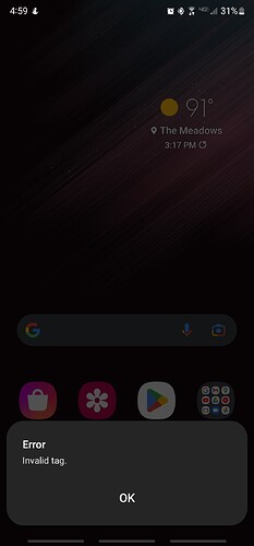

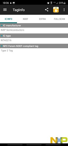

I got my NExT installed yesterday. It was giving me no issues. I tried to write using NFC tools and the writing was successful. I went to scan it and now android gives me an invalid tag error. I tried to reformat it with NFC tools , NXP writer, and DT support tool. It does scan using the NXP reader, but not the writer. The full scan data is below.
The tag is showing up at a ntag216 and not a mifare.

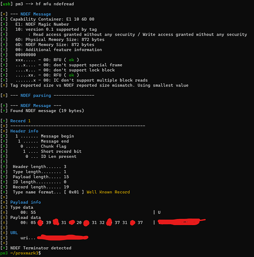

I tried using the Proxmark to write to the NExT . But when I do I just get a bunch of auth errors. I think when the write went wrong it locked the chip.

Can you do a dump of the memory from the proxmark?
What are the commands to run

can you detail exactly what you mean here?
When I try and write anything to the chip I get an AUTH ERROR. I tried writing a dump file from another tag to it I got the auth error on every sector and every block. Does anyone have a dump file from a fresh NExT I try writing to mine?

What I mean is, post the commands you are trying and the responses. Screenshots tend to work best.
I realized that I was running the wrong commands. I was trying to do and restore the information from a Mifare classic. That is why I was getting all of the errors. This is what the NDEF scan shows from my Proxmark. I do see at the end it has an NDEF terminator at the end. Could this be causing the issue?
Here is what I get when I do a DUMP. The “X” represents a phone number.

This is the error I get when trying to scan on android.
