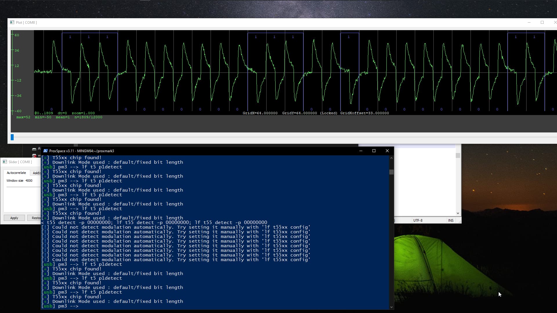

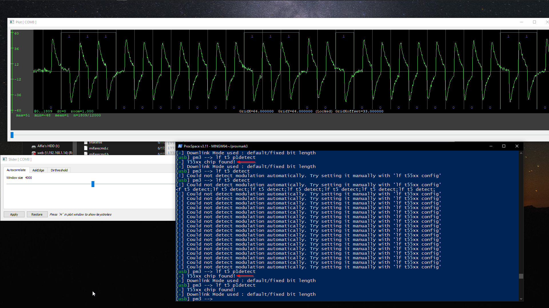

It is significantly slower, which is actually quite helpful but unfortunately, did not provide any helpful results.
I did run lf t5 p1detect to make sure I was in the right spot as shown in my screenshot. I was pressing rather hard once again so I was able to get a good read.
hm,
retry your detects but let’s password them and chain them for continuity.
run this as one command
lf t55 detect -p 00000000; lf t55 detect -p 00000000; lf t55 detect -p 00000000; lf t55 detect -p 00000000; lf t55 detect -p 00000000; lf t55 detect -p 00000000; lf t55 detect -p 00000000; lf t55 detect -p 00000000
Still the same result
Still running lf t5 p1detect to ensure I’m in the right spot.
Edit:

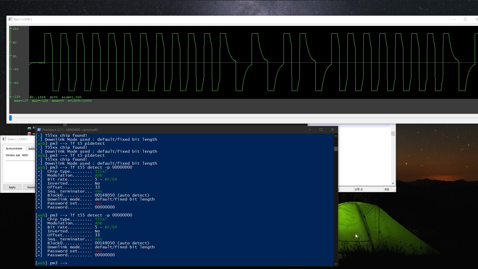

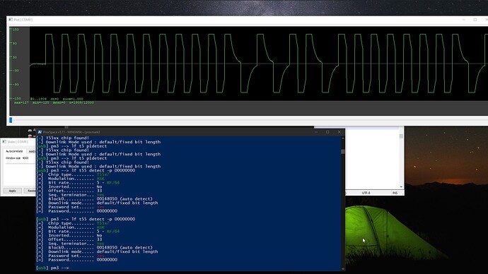

Not too terribly related, but reading the “bricked” T5577 with the entry lf t55 detect -p 00000000 does seem to work.
