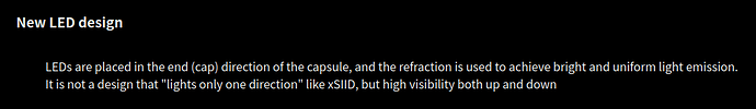

It is probably done that way as to avoid making the device longer, and as a side benefit may help with the way the light refracts through the end cap:

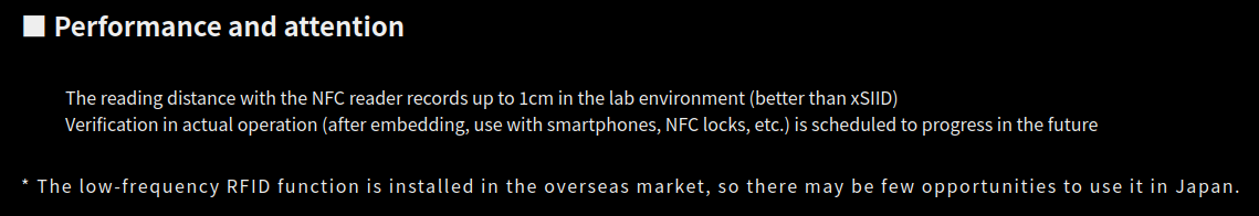

Unlikely that it does in any major way. On some tiny level maybe, but this quote (below) suggests the opposite, possibly due to an increased antenna size or the angle of the antennas pushing each other closer to the glass.
