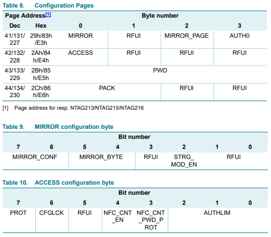

I dare say that 99.99% of people would never look at it, let alone miss it, but the I2C chip doesn’t appear to have the NFC read counter that’s available in the 216.
It’s trivially bypassed and it’s difficult to work with if you have multiple readers, but using the counter can provide a (ridiculously weak) form of replay protection.

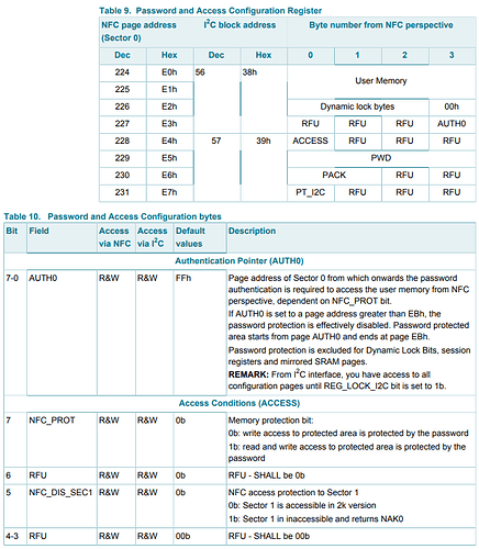

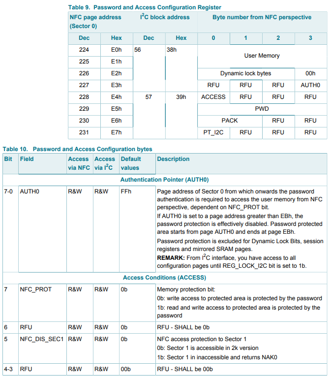

Yes this is a good catch.. we use the NT3H2111 which does have a counter but it’s only accessible via I2C session registers, not over NFC.. so yes good catch. There are other differences related to the config page E3 as well;
  • no NFC accessible read counter (accessible via I2C session registers only)
  • no data mirror (used by the 216 to insert the counter value into normal memory page read)
  • other differences based on memory size of I2C chip
NTAG I2C
NT3H2111_2211.pdf (762.7 KB)
NTAG 216
NTAG213_215_216.pdf (1.4 MB)
