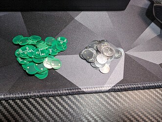

The coils are orphaned from old rfid tags. Shoot me your address in a dm and I’ll send a PCb out to you
Quick Explaination of this PCB, and how i used it to tune some of these tiny NFC antennas for my use.

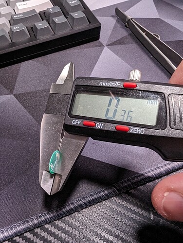

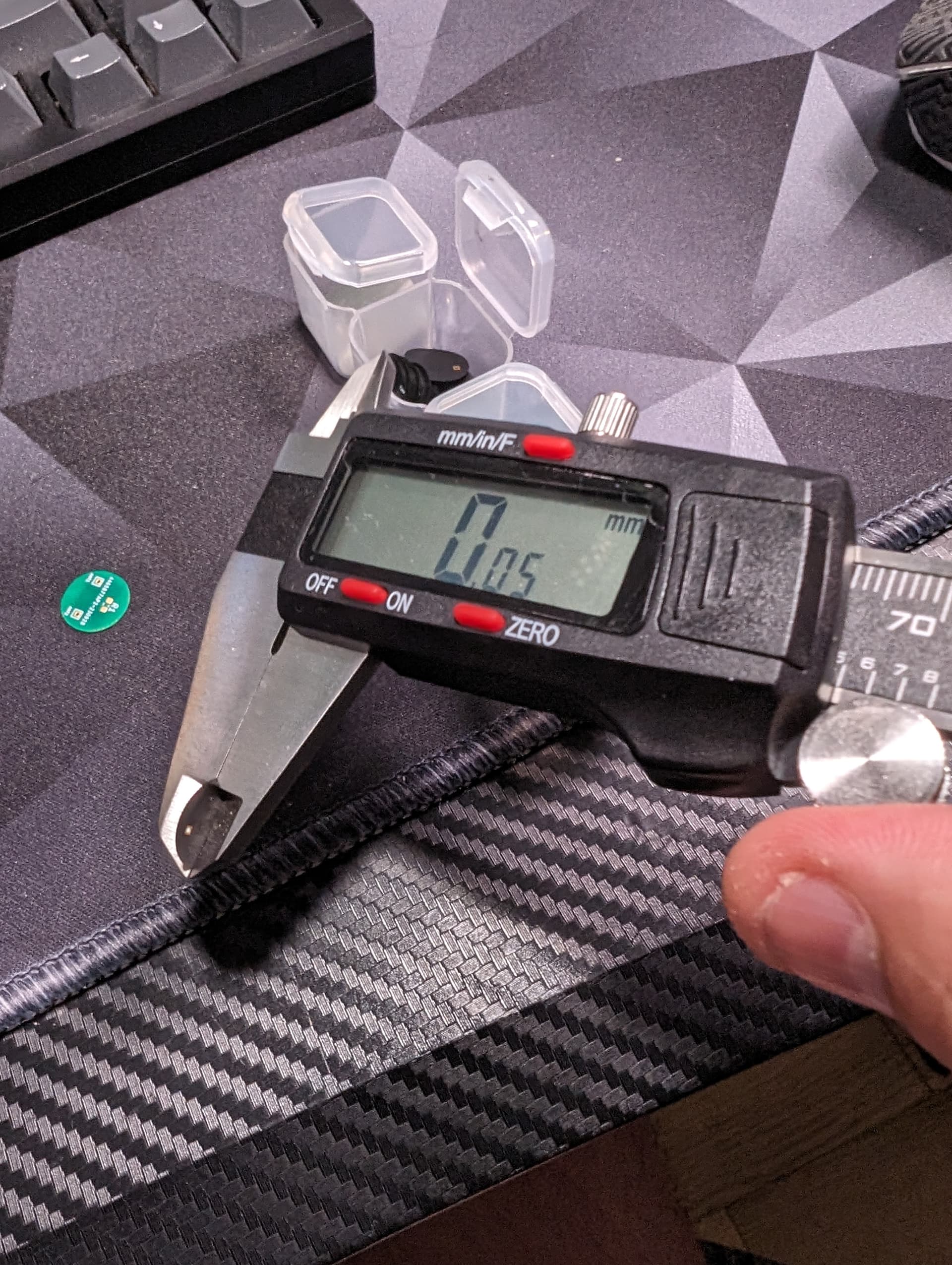

Fr4 PCB isn’t that thick
But the flex… oh boy she is skinny
For those wondering that is 15x my Patience for my wife’s spending habits
I didn’t realize these were flexes. That would have worked. I think @invalid_signal wnated to cast them in flexible phone cases.

Ive sent out about 2 dozen of these so far and i have to say, i am really dissapointed with the lack of cookies that are popping up in this thread…

I can confirm, they are wafer thin
I have some spare and they will be making their way into some projects
I’ll do some measured testing, but for the moment I will say the range increases I am seeing are AT LEAST double that than without it.
If you are struggling to read your implants, I would strongly recommend you get yourself one (or more)
He was sending these out for free, including postage within North America,

Two things to note. @pilgrimsmaster received completed built antennas from my own stock that I made up for testing tuned with a 22pf capacitor. I was giving out the unbuilt pcbs for free as I had limited stock of available antenna to build with these.
Second which he brought up and I neglected to mention in this post, these can be used in conjunction with qi wireless charging without any perceived interference.
And yes they are crazy thin which does make the flex pcbs a pain to solder to.
This project isn’t complete by any means, I still have a bunch of these pcbs and will offer them until I’m out. V2 should have an integrated antenna when I can get some time to devote to it. I’m just kinda stewing because my first round of integrated antenna was a complete flop. I’m getting there though.
