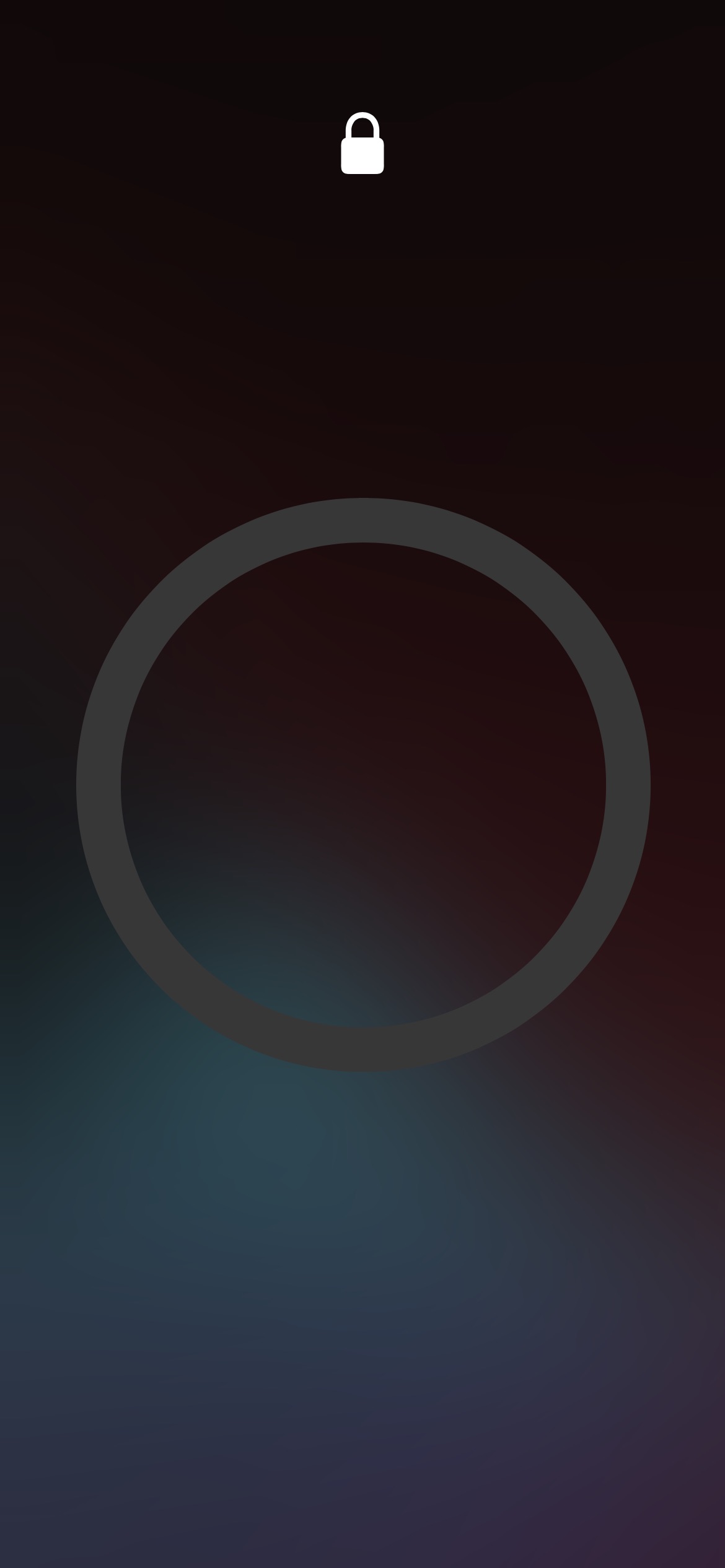

I’ve tried since Tuesday, but so far the LEDs on the RFID Diagnostic Card, XFD Field Detector, xLED implant didn’t light up near the MagSafe NFC coil.
The only MagSafe accessory I could buy at a local consumer electronics store is Apple’s silicon case for the iPhone 12/12 Pro.
I tried scanning the silicon case for NFC tags with multiple RFID/NFC readers, but haven’t gotten any results so far.
When I attach the case to the iPhone, this appears on the screen:
Maybe this is triggered by the magnets inside the silicon case? I’ll do some more experimenting in the next couple days.
The exploded view of the magsafe system in the OP seems to include a magnetometer, so I would say this is almost certainly what is happening. I hope Apple releases more interesting accessories soon that are more likely to need the NFC capabilities…
it might not be an actual NFC scannable “tag”… it might be something magnetically coupled but proprietary… dunno…
Considering it’s apple, imma go ahead and guess that its probably proprietary…
In my experimentation the different coloured phone cases show a different (matching) animation on the screen and works from both the front and back of the case so I’d say it’s definitely active and communicating some kind of data rather than just detecting a magnet in the case.
