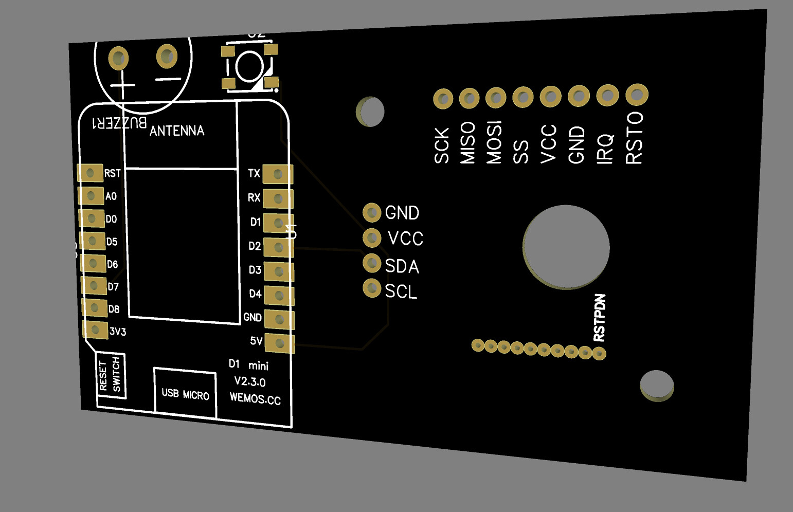

I even designed my own PCB to make them easy. But used esp32 not the 8266.
Looks awesome! How would I build one? Does it use the same firmware as the other one? Also any 3D files for a case?
This one was running some custom stuff since I was using spi not i2c. But I can make one that follows official guide and make a 3D modeled case for it. Give me like an hour and I’ll upload some board designs and 3D models for a case.
You are amazing!
Does anyone want anything extra on this board? Maybe power headers instead of USB power, or more LEDs? The buzzer is huge so I kinda just don’t think anyone should use those headers…

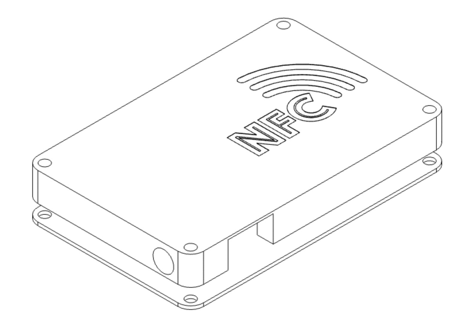

3D printable case for new board design.
Everything looks great! I would add some “waves” on the case haha
I tried putting it over the reader area of the scanner. I am also including the cad files so anyone can change it in any way they want. I will probably do it in openScad next and make a case designer UI in openJScad so that people can design their own cases in the browser.

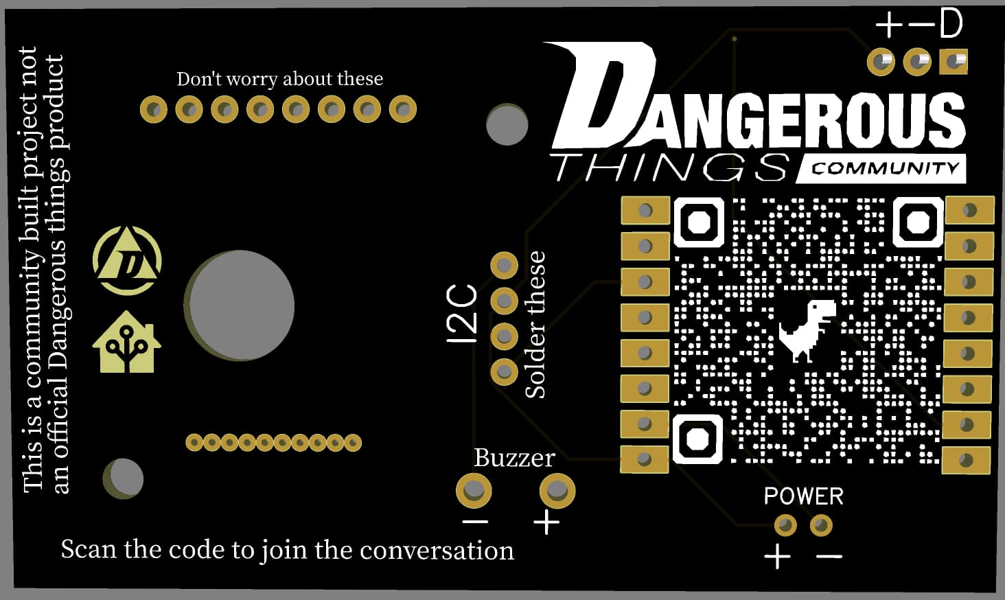

I that might cause confusion … the qr code is great… but putting the logo on makes it feel like a Dangerous Things product. I appreciate the inspiration behind it :slight_smile: I just think it’s probably not a good idea to label non-DT products with the DT logo though.
However… after thinking about it a moment… I mean if this is something you wanted to open source then we could make a repo on GitHub and it could be a DT community project?
Yeah opening it up would be a great idea. Maybe say “Community” in the white stripe?
That’s a great idea
kinda like this.
I added some stuff just to make things clear and for fun! (It’s all for fun isn’t it?) The DT and HA icons are only there because I wanted reason to test out exposing the copper in a cool way. So those are shinny ooooh ahhhh I tried to do it with the community logo but where it is makes it so the logo would actually end up being parts of the RGB led data line and yes that would work, but it isn’t smart.
You can also see that I added power headers if you want it to be soldered in power not usb. (also safer since no one would take the usb and re-flash the board) the buzzer is labeled but put under the reader since I imagine not many will use it and opt for LED instead. I also extended the led data out, power, and ground into their own sets of headers if you wanted to do a led ring, strip, or whatever.

I have a design suggestion,
Since this may be used in place of an old alarm panel or similar may a suggest adding an AC/DC 12V regulator down to 5VDC (I presume?).
A wide input regulator would be even better, but all alarm panels I’ve come across are 12VAC.
If not the regulator itself maybe a common footprint where one can be installed?
okay, I had to move some stuff around to make it work, but if we straight solder this to the board it will fit under the wifi board that stands a little bit high because of the headers. You will solder 12v to the back of the board where labeled.
I didn’t want that under the antenna so it did force me to move some stuff around on the cosmetic side. But now we have a larger QR code.
