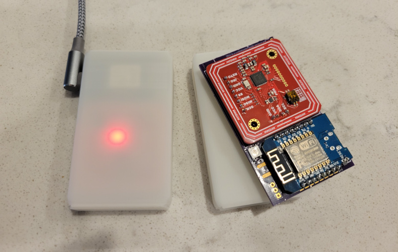

In case anyone’s interested, I created a new case for the DT Community Wi-Fi reader.
https://github.com/trigat/Dangerous-Things-Community-Wi-Fi-Reader-Case
