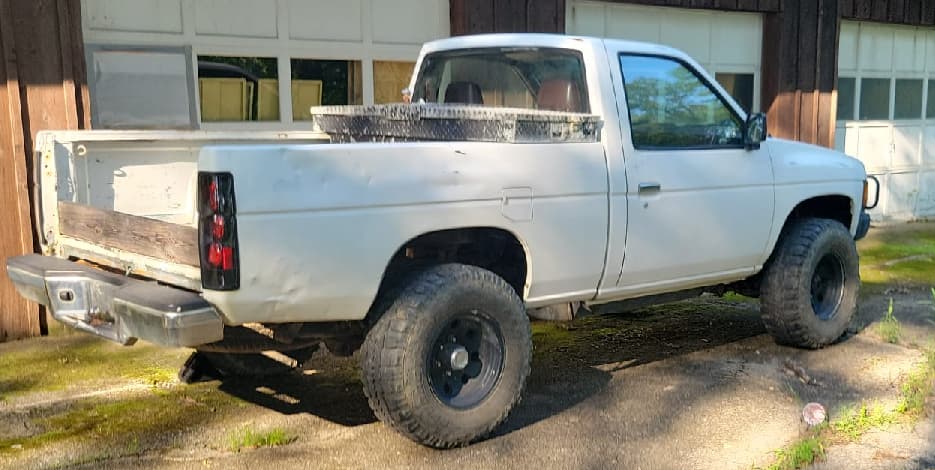

I just became the owner of a 4x4 1991 Nissan Hardbody, and like all things I’ve got to tinker a bit.

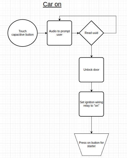

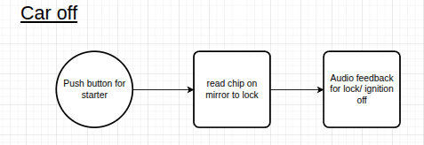

Proposed Workflows
I still need to do some figuring here with the “off” as the attempt is to bypass all the smarts in the start button kit but we’ll see :man_shrugging: maybe there’s an easier way.

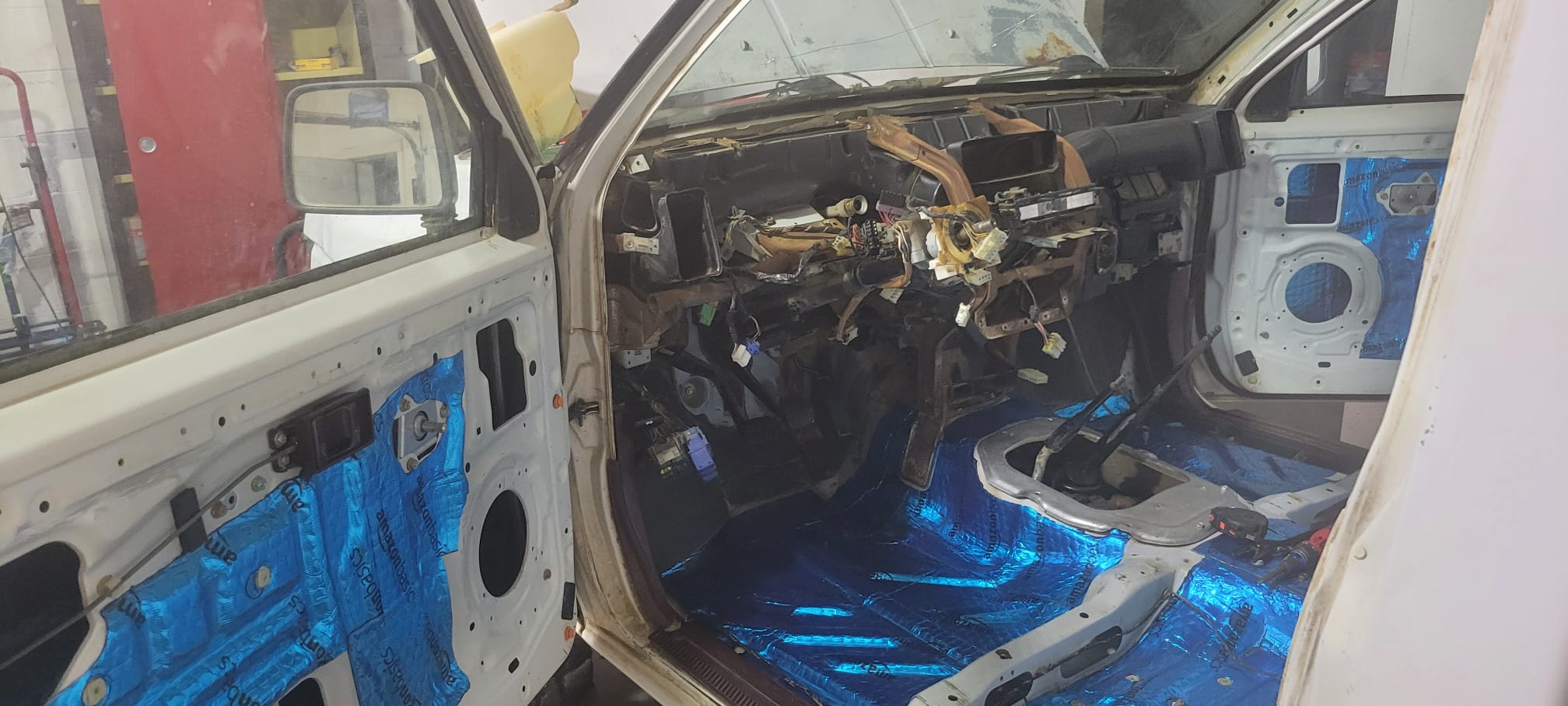

The car is currently in shambles so the next update may take a min.
