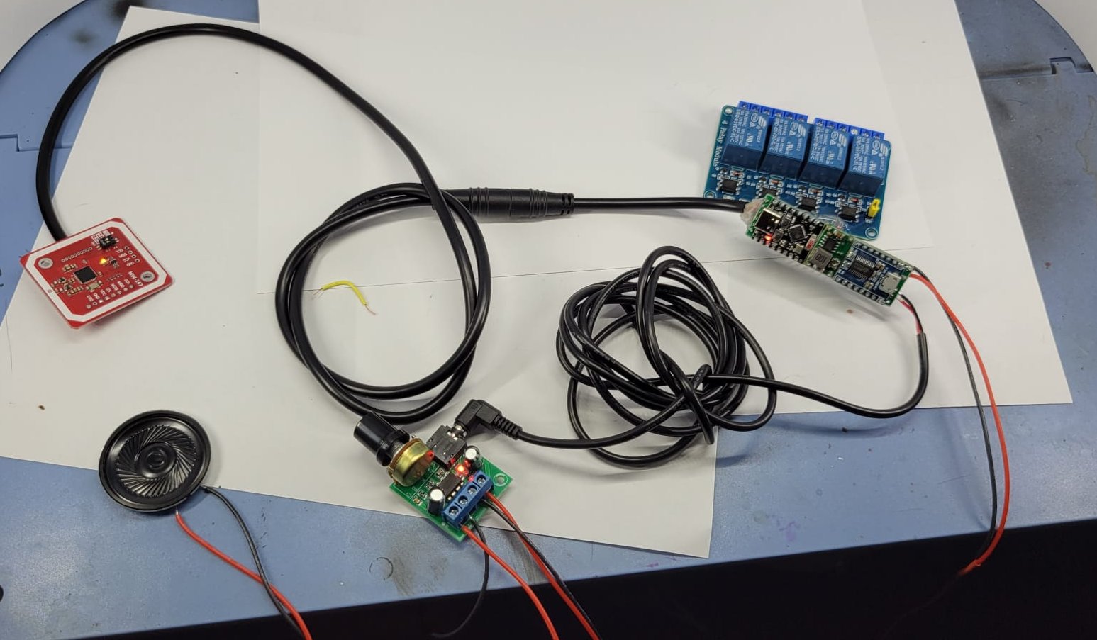

Alrighty. Still waiting on the hardware to come in, but here’s what I think is a good start with the new revision.
edit: (I moved the repo, I got tired of git fighting me with the upstream dependency. This has definitely morphed a bit beyond what I expected and doesn’t resemble the original at all anymore.)
Small update,
hardware is all here. currently trying to put together an “assembly/ flashing” guide.
Then I’m on to testing/ tinkering with all these pieces.
Follow along with the docs below.

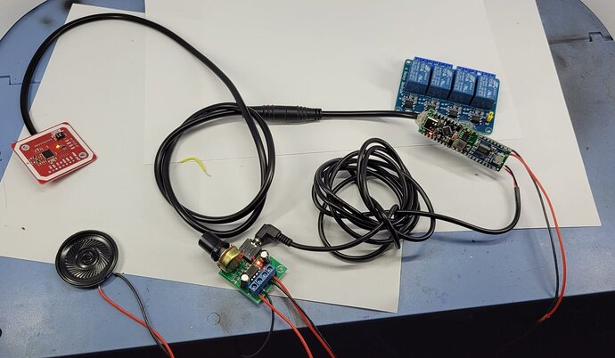

Welp. Its assembled kinda. Now to see if this codebase actually does what I think it does.
More to come!
Still on this one, just today got the board flashed and running the code from the repo!

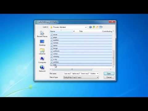

Tomorrow on to testing the implementation and figuring out how to add audio files in an easy way
Power the ss. To upload the sound file. Label them 001 -005.mp3 respectively
Next update!
I’ve got things wired and programmed. code in the same link as above.
