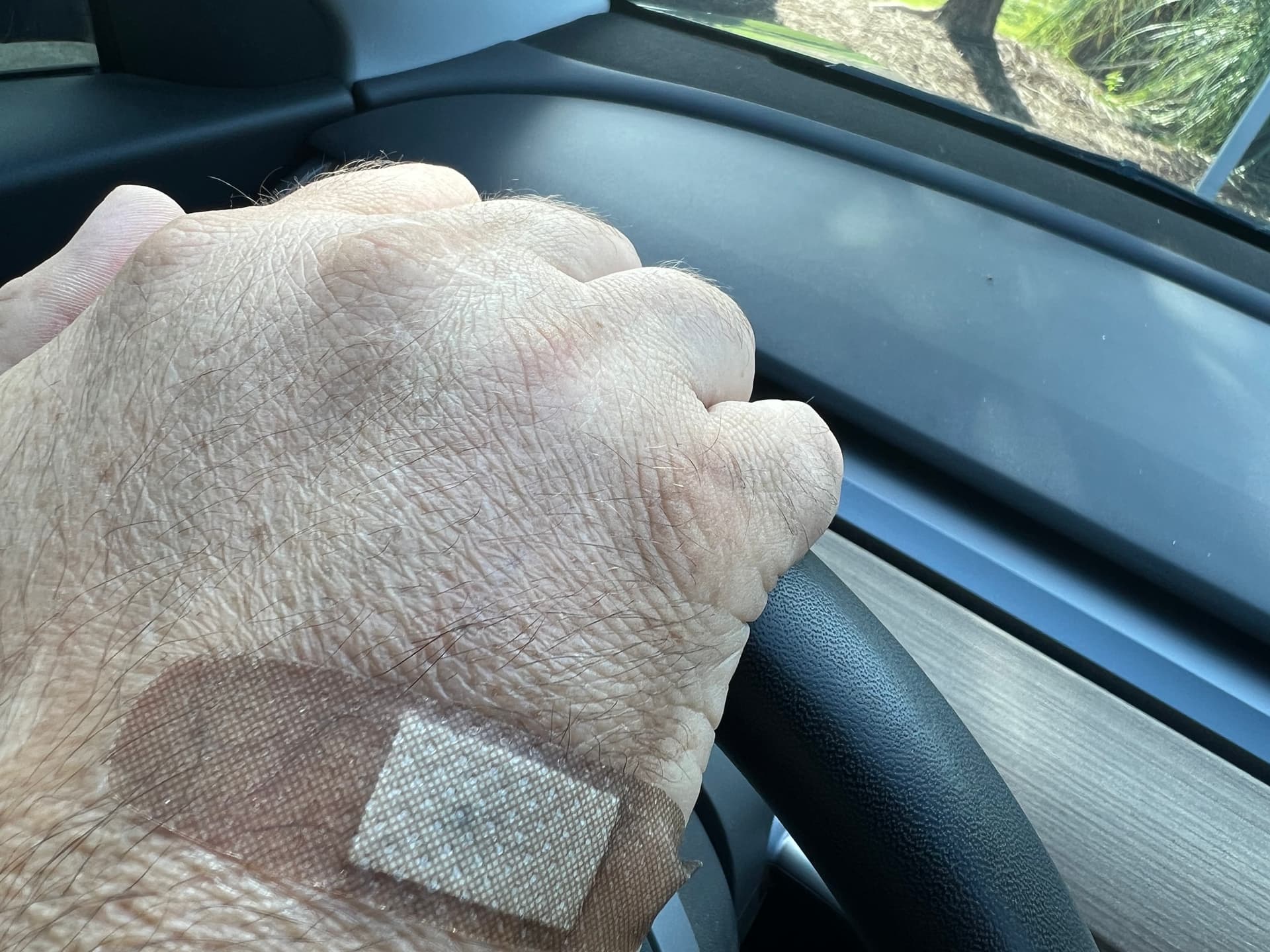

I’m a dev and type all day every day. I put mine with the Apex logo facing out on the hairline of my pinky on the left hand. It had no healing issues, I did it on Wednesday and it was fine at work the rest of the week. (Picture for location reference)

My installer went with chip out. He also used a scalpel for the install. It’s been in a little over 13 hours with minimal swelling so far. I have been able to scan it on my Tesla and I can say (at least to me) it works better inside vs. outside the body.
